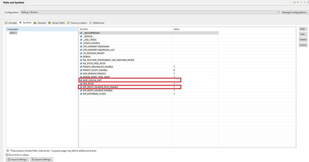

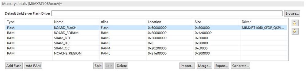

I used "evkmimxrt1060_lwip_ping_freertos" original example code on MIMXRT1060-EVK board for ping test.
The attachment "original example code.txt" is log which I used example code for ping test.
The result seems ping function working well.
The other attachment "packet drop while boot to SDRAM.txt" is example code which modify memory details to boot to SDRAM.
The packet was dropped after ping for a while.
The code which I modified are as below,
May I ask why boot to SDRAM will effect the ping function?
Did I use the wrong way to config my project to boot to SDRAM?
Please give us some advise.

ENET buffers need to store in non-cacheable region.  please try below code change.
Original definition:(enet_ethernetif_kinetis.c)
    SDK_ALIGN(static rx_buffer_t rxDataBuff_0[ENET_RXBD_NUM], FSL_ENET_BUFF_ALIGNMENT);
    SDK_ALIGN(static tx_buffer_t txDataBuff_0[ENET_TXBD_NUM], FSL_ENET_BUFF_ALIGNMENT);
Change to:
  AT_NONCACHEABLE_SECTION_ALIGN(static rx_buffer_t rxDataBuff_0[ENET_RXBD_NUM], FSL_ENET_BUFF_ALIGNMENT);
  AT_NONCACHEABLE_SECTION_ALIGN(static tx_buffer_t txDataBuff_0[ENET_TXBD_NUM], FSL_ENET_BUFF_ALIGNMENT);
