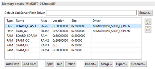

Also using the RT1052, I updated the MCU settings to include the second FLASH, and also had it use the same MIMXRT1050_SFDP_QSPI.cfx driver:

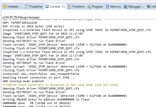

When I start the debugger, in the debug messages console, I see that MIMXRT1050_SFDP_QSPI.cfx is called twice.
But when it probes it uses the same address (0x60000000) twice instead of 0x62000000 for the second FLASH.
Second RT1052 question: How do I configure the MCUXexpresso so that the debugger can program code into the second FLASH?

2. RT1052 question: How do I configure the MCUXexpresso so that the debugger can program code into the second FLASH?
Answer: You can't do it like that, as you know, MIMXRT1050_SFDP_QSPI.cfx  is the flashloader used to download the code to the external QSPI flash, it is default to program the QSPI like the MIMXRT1050-EVKB qspi connections, so if you add another QSPI flash, I think you need to write your own program algorithm file, you can refer to the  MIMXRT1050_SFDP_QSPI.cfx source code, which you can find it from this folder:
<install dir>/Examples/Flashdrivers/NXP/iMXRT
You can write your own program file, which is used to program your second qspi flash.
