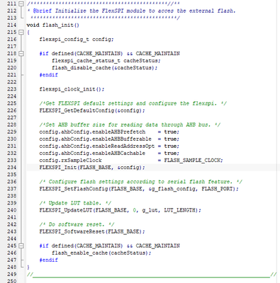

I am building my own module to access an external flash memory using a MIMXRT1061CVL5B controller. It is built on the example in the SDK flexspi_nor_polling_transfer, I keep running into a hardfault that is caused by the FLEXSPI_Init, and I am almost sure it is from the function call FLEXSPI_SoftwareReset.
I tried to add the object files to the RAM in the .icf file as it is in the SDK example but that didn't help
Can anybody help me?
Thanks in advance.

I am aware of the difference between the flashes. I am using winbond W25Q64JVSSIQ, and I am able to boot from it with no problem. The QE bit is by default enabled (actually can't be cleared in this flash). Can you please give an example of how could the configuration for the initialization be different? I customized all my functions and the LUT to be compatible with the flash I am using, only the initialization is the same as the one in the flexspi_nor_polling_transfer example. Please see below my init function.

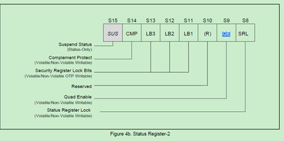

3) QE bit
app.h
From
#define FLASH_QUAD_ENABLE 0x40
to:
#define FLASH_QUAD_ENABLE 0x02

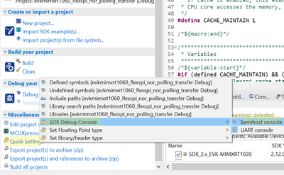

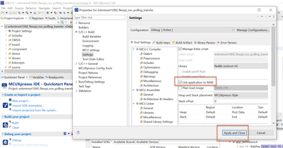

kerryzhou
Hi @Lukaz ,
   Thanks very easy if you are using the MCUXPresso IDE, just do the following configuration:
I need to use the RAM code to test your external flash totally works at first.
You can check the printf information with the UART, or you can check it in console if you enable the semihost:
Please test it on your side, and share me your printf information after the code modification.

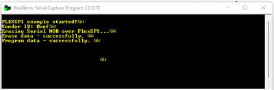

Lukaz
Hello Kerry,
I used the linker file that comes with the flexspi_nor_polling_transfer SDK example and was able to run the application from the RAM and it works successfully.

kerryzhou
Hi @Lukaz ,
   Good!
   So, from your printf log, you are totally works OK.
   So, it already pass the the software reset you mentioned.
   Please help to check it, I think your issue is solved now.
   If you still have issues, just kindly let me know.
Kerry
