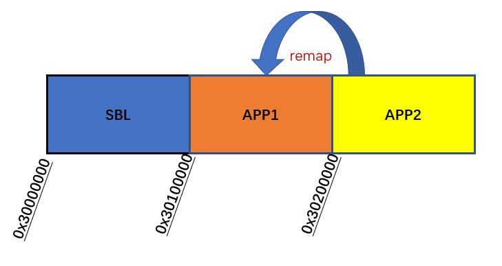

Regarding remap, we can know from the SBL documentation that RT1170 can directly support it:
Fig 1
Usually, if combined with SFW for SD card, cloud and other app updates, the remap function can be directly supported. Because SFW currently only supports two IDEs: IAR and MDK, and does not support MCUXPresso IDE, it is not particularly convenient for customers to use MCUXPresso to develop apps. Moreover, customers do not need to use an SD card or network cloud to update the code. SBL's ISP Updates are enough. So how to use SBL to implement the remap function of two MCUXpresso apps? For MCUXpresso App, you can use one project, so you only need to modify the content to identify different apps and burn them to different flash addresses. The specific implementation methods and steps are given below.
The spatial structure of SBL, APP1, and APP2 codes is as follows:
Fig 2

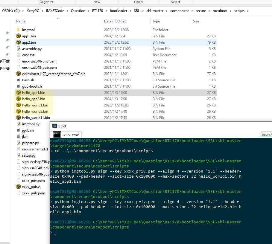

Use app1 printf code, to generate the hello_world1.bin,then add the secure header which match to the SBL, generate the hello_app1.bin.
Use app2 printf code, to generate the hello_world2.bin,then add the secure header which match to the SBL, generate the hello_app2.bin.
Now, give the details how to generate the related secure app:
Open sbl-master\target\evkmimxrt1170\env.bat:
Change the path to:
cd ..\..\component\secure\mcuboot\scripts
copy the mcuxpresso project generated bin file:hello_world1.bin and hello_world2.bin
to:
sbl-master\component\secure\mcuboot\scripts
Use the following commander:
python imgtool.py sign --key xxxx_priv.pem --align 4 --version "1.1" --header-size 0x400 --pad-header --slot-size 0x100000 --max-sectors 32 hello_world1.bin hello_app1.bin
python imgtool.py sign --key xxxx_priv.pem --align 4 --version "1.1" --header-size 0x400 --pad-header --slot-size 0x100000 --max-sectors 32 hello_world2.bin hello_app2.bin
to generate the hello_app1.bin, hello_app2.bin.

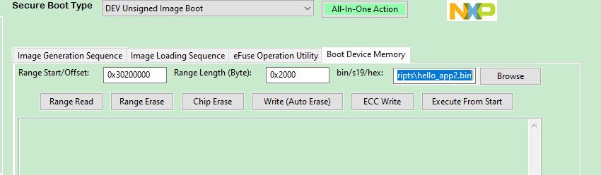

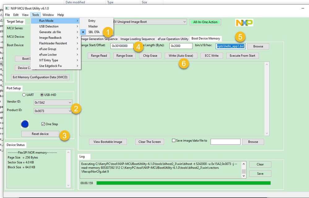

Use the MCUbootutility SBL OTA run mode, after board reset, in 5 seconds to connect the board, then burn:
hello_app1.bin to 0X30100000
hello_app2.bin to 0X30200000
Fig 4
Fig 5
After downloading, exit MCUBootutility.

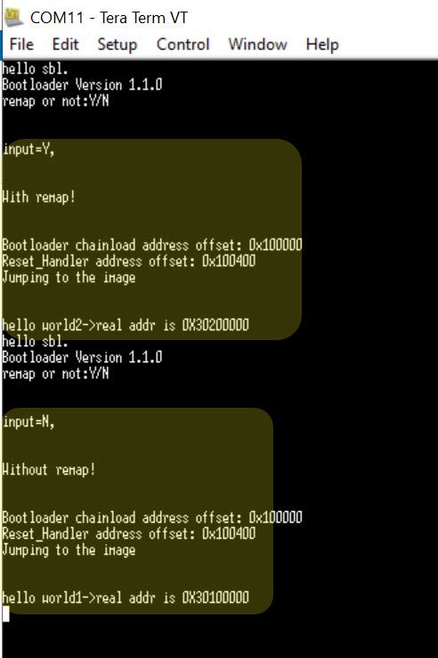

Reset the board, in the console wait the log appear, then input ‘Y’ or ‘N’ to select which app boots:
‘Y’: remap, APP2 boot
‘N’: without remap, APP1 boot
Test result is:
Fig 6
From the test result, we can see the remap function already works OK.
