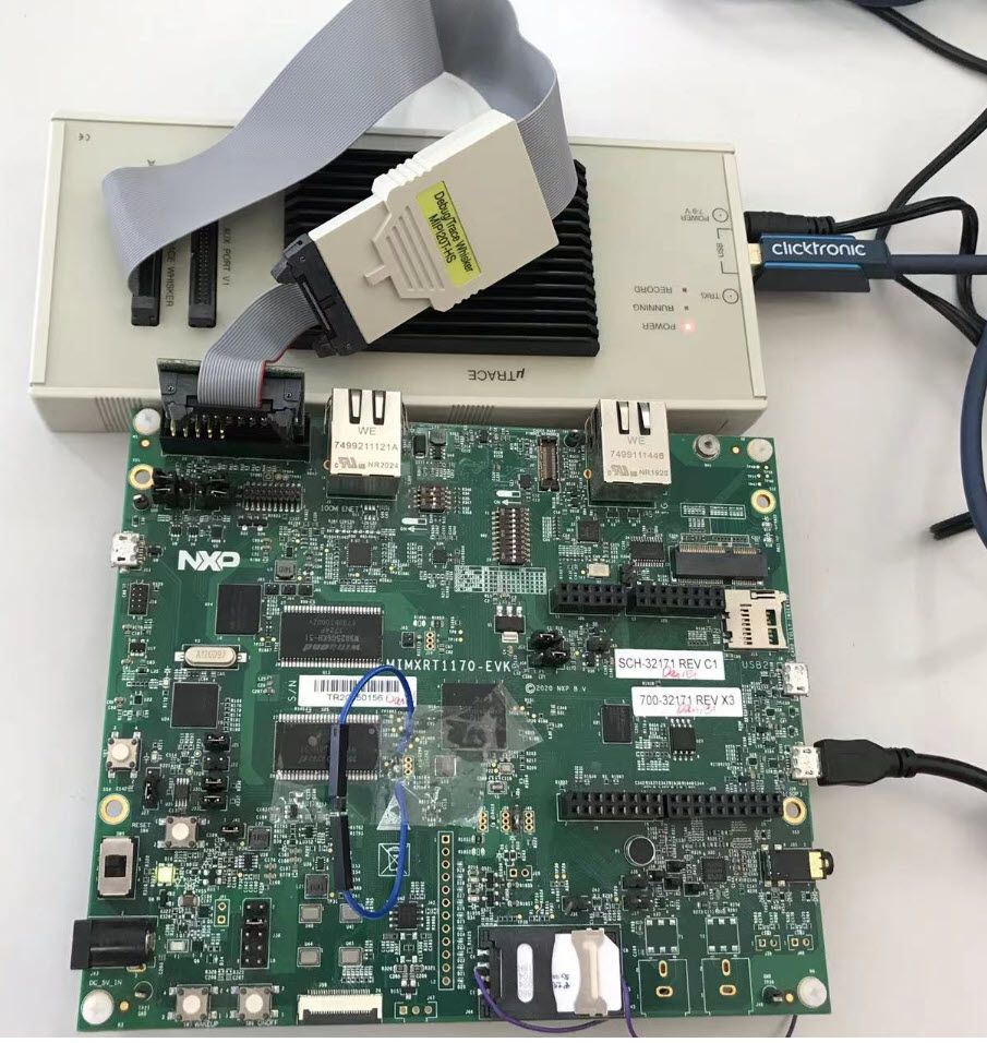

Lauterbach:LA3050
MIMXRT1170-EVK rev C1:
The hardware modification point is to remove the onboard resistors R187, R208, R195 and R78. The purpose is that J6 prohibits external circuits from interfering with JTAG related pins. Disconnect J5, J6, J7, J8, that is, disconnect the onboard debugger, and use an external Lauterbach connection to J1. The connection situation is as follows:
Fig 1
RT1170 directly supports both SWD and JTAG by default, so unlike RT10XX which needs to modify the fuse to convert from SWD to JTAG, RT1170 can directly use the JTAG interface.

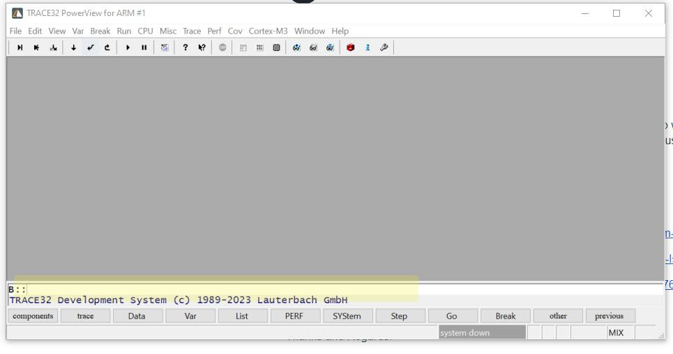

2.2 Software operation
Download Lauderbach's supporting software and install it. After installation, open the TRACE32 ICD Arm USB. If the Lauderbach device is connected, the interface will open successfully.
Fig 2
At this time, you can enter the relevant commands in the yellow box in the picture above.

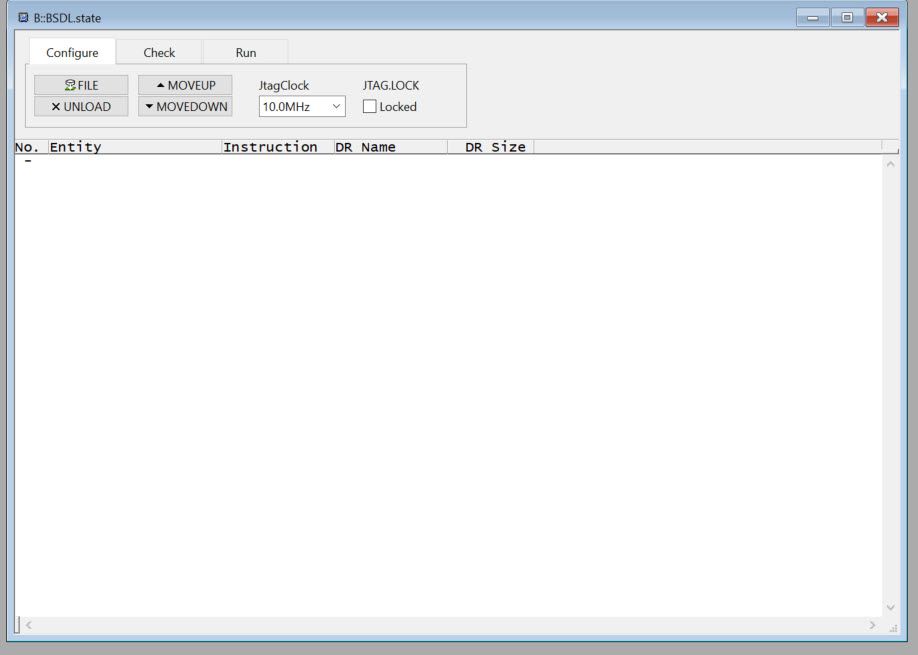

Next, enter the following command in the window to open the boundary scan window and the i.MXRT1170_BSDL.bsdl file:
SYStem.Mode Down
BSDL.RESet
BSDL.ParkState Select-DR-Scan
BSDL.state
Here, it will open the window:
Fig 3

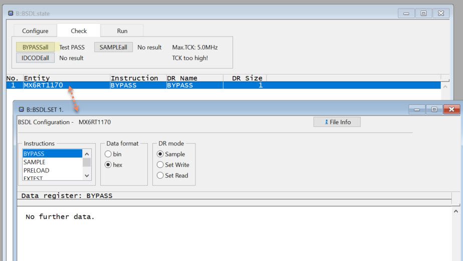

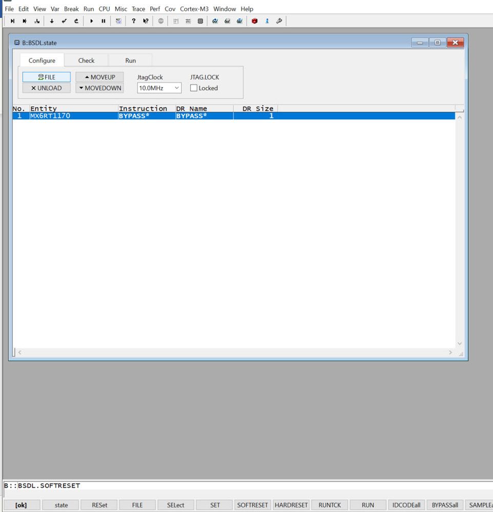

Click FILE item, input the downloaded i.MXRT1170_BSDL.bsdl, then in the window.,input the commander:
BSDL.SOFTRESET
Fig 4

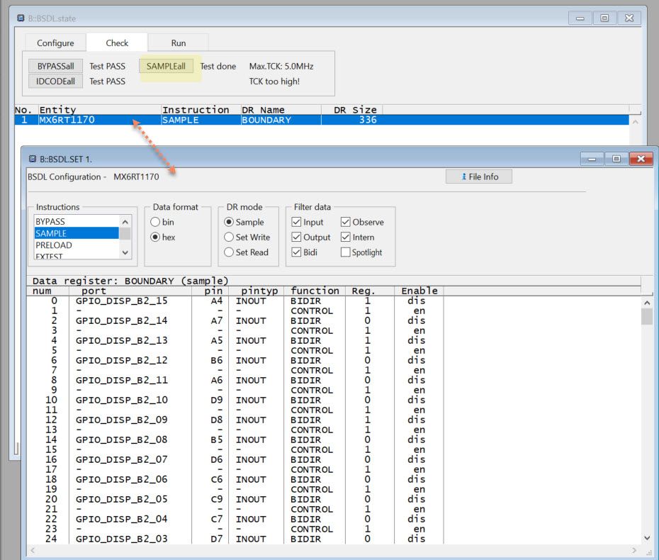

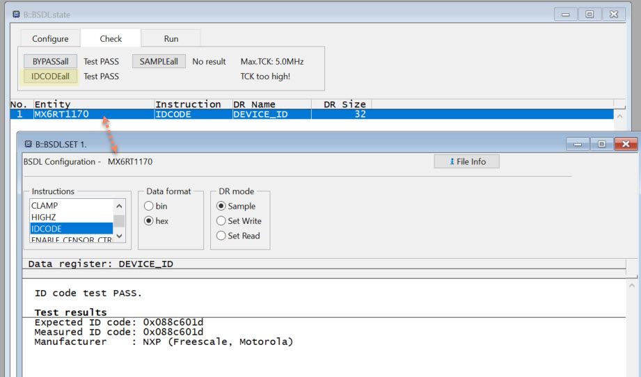

Click check->BYPASSall,IDCODEall,SAMPLEall, make sure the 3 methods can be passed.

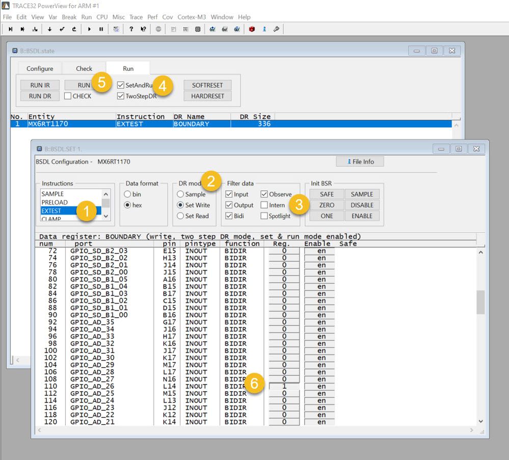

To test the output control situation, it need to do the following operation:
BSDLSET 1.: instructions->EXTEXT, DR mode->Set Write, Fileter data->uncheck intern
BSDL.state->Run: check SetAndRun, TwoStepDR, Click RUN.
BSDLSET 1. Can control the related pins, eg, GPIO_AD_26 is on the on board D34 LED. 1 ON,0 OFF.
Fig 8

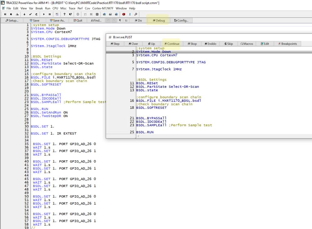

2.3 Automation control command script
As can be seen from Section 2.2, single-step operation requires manual typing of commands. In actual testing, the efficiency is very low, so scripting language can be used to directly implement automated command control.
Below, taking RT1170 as an example, we provide a script to control the on-board D34 light on and off. In this way, when the TRACE32 software is opened, you only need to open the script directly, enter the debug mode, run it to the end with one click, and check the on-board light control status.
Script language file, the suffix is .cmm, step: File->New Script, enter the following script command:
;system setup
SYStem.Mode Down
SYStem.CPU CortexM7
SYSTEM.CONFIG.DEBUGPORTTYPE JTAG
SYStem.JtagClock 1MHz
;BSDL Settings
BSDL.RESet
BSDL.state
;configure boundary scan chain
BSDL.FILE i.MXRT1170_BDSL.bsdl
;Check boundary scan chain
BSDL.SOFTRESET
BSDL.BYPASSall
BSDL.IDCODEall
BSDL.SAMPLEall ;Perform Sample test
BSDL.RUN
BSDL.SetAndRun ON
BSDL.TwoStepDR ON
BSDL.SET 1.
BSDL.SET 1. IR EXTEST
 BSDL.SET 1. PORT GPIO_AD_26 0
 WAIT 1.s
 BSDL.SET 1. PORT GPIO_AD_26 1
 WAIT 1.s
 WAIT 1.s
 WAIT 1.s
 WAIT 1.s
 WAIT 1.s
 WAIT 1.s
 WAIT 1.s
 WAIT 1.s
 WAIT 1.s
Function, the led will be blinking 5 times, duration is 1s.
Save the script, then debug it.
Fig 9
