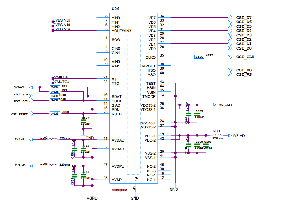

we use tw9912 in imx8qxp with parallel-csi, tw9912(yuv422) reg config is from imx6d which works fine. but camera preview data is not correct. there are not  detail parallel-csi reg explantation in reference manual. can you do some help?

Hi jiu
Ov5640 parallel CSI camera is supported by default, the dts is fsl-imx8qxp-mek-ov5640.dts.
One can refer to the driver to customize parallel CSI camera.
If the captured image flicker serious, or the data value is all 0, one can check the clock polarity
of custom camera and modify the polarity control bits in register CSI_CTRL_REG.
For supported format one can check and configure DATA_TYPE_IN.

jiujinhong
Hi Igor,
The TW9912 is a low power NTSC/PAL/SECAM video decoder chip that also supports analog
component video as its input. The video decoder decodes the base-band analog CVBS or S-video
signals into digital 8-bit 4:2:2 YCbCr format. The analog component video is digitized into 8-bit YCbCr
format. On the digital output, it supports the standard BT.656 format for interlaced video. It can also
output progressive BT.656 format in the case of progressive component input or by converting the
interlaced video into progressive format.
Question:
even if hardware connect HS/VS to CSI_HSYNC/CSI_VSYNC, it shouldn't use for BT.656, right?
why parallel csi driver need to config VSYNC_RESET_EN/EXT_VSYNC_EN?
else if (pcsidev->mode & CCIR_MODE) {
val |= (CSI_CTRL_REG_CCIR_EN |
CSI_CTRL_REG_CCIR_VSYNC_RESET_EN |
CSI_CTRL_REG_CCIR_EXT_VSYNC_EN |
CSI_CTRL_REG_CCIR_ECC_ERR_CORRECT_EN);
1,436 Views
jiujinhong
Hi Igor,
if set CSI_CTRL_REG_UV_SWAP_EN, the camera works fine, otherwise  it drops some color.  tw9912 spec told that it support Ycbcr(4:2:2) output and tw9912 driver register with YUYV. Why? it seems that SOC support YVYU only?
1,436 Views
jiujinhong
Hi Igor,
the camera working fine after force pcsidev->uv_swap. one question need to help from you.
tw9912 output format is  BT656 YUV422 and  Parallel Capture interface is hooked to the Imaging subsystem via the Pixel Link.  mxc_pcsi_csr_config below PL data type to DATA_TYPE_OUT_YUV444,
question is , which one convert YUV444 to YUV422? bypass mode don't need any convert?
/* Config PL Data Type */
val = IF_CTRL_REG_DATA_TYPE(DATA_TYPE_OUT_YUV444);
writel(val, pcsidev->csr_regs + IF_CTRL_REG_SET);
/* Config CTRL REG */
val = readl(pcsidev->csr_regs + CSI_CTRL_REG);
val |= (
CSI_CTRL_REG_DATA_TYPE_IN(DATA_TYPE_IN_UYVY_BT656_8BITS) |
CSI_CTRL_REG_HSYNC_POL |
CSI_CTRL_REG_MASK_VSYNC_COUNTER(3) |
CSI_CTRL_REG_HSYNC_PULSE(2));
1,436 Views
jiujinhong
it works fine now.  tw9912 need to set pcsidev->mode  CCIR_MODE, data type need to set  DATA_TYPE_IN_UYVY_BT656_8BITS
