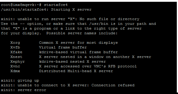

Hi:all
I want to create a desktop system (like xfce)base on imx8mqevk.I saw meta-xfce in the yocto project.How to configure it to work?
kernel4.14.78
imagefsl-image-qt5-validation-imx
Here the steps I did:
  1. let the bblayer.conf know meta-xfce
BBLAYERS += " ${BSPDIR}/sources/meta-xfce "
  1. add packagegroup to fsl-image-qt5-validation-imx.bb
CORE_IMAGE_EXTRA_INSTALL += "packagegroup-xfce-base"
  1. then bitbake
 DISTRO=fsl-imx-xwayland MACHINE=imx8mqevk source fsl-setup-release.sh -b build-xwayland
 bitbake fsl-image-qt5-validation-imx
  1. run startxfce4 in boardpastedImage_1.pnghow to solve this problem,please give me some advices,thanks!

Hello gao,
The MX8 not support X11 is based on weston, the xcfe will not work. Or if you want to try the ubuntu that our third party make:
https://boundarydevices.com/wiki/ubuntu-for-nitrogen8/
