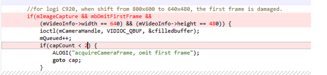

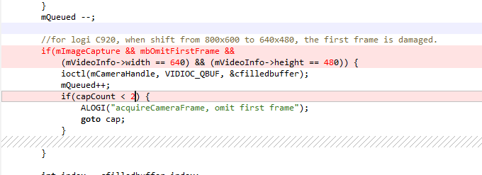

   Try to modify camera HAL like following
(1) Open UvcDevice.cpp
(2) find these code:
Then change "capCount < 2" to "capCount <10", then re-compile the HAL and try to capture image.
Weidong

佳杰吴
Thank you for your reply.
I can't find the code
in my UvcDevice.cpp,
