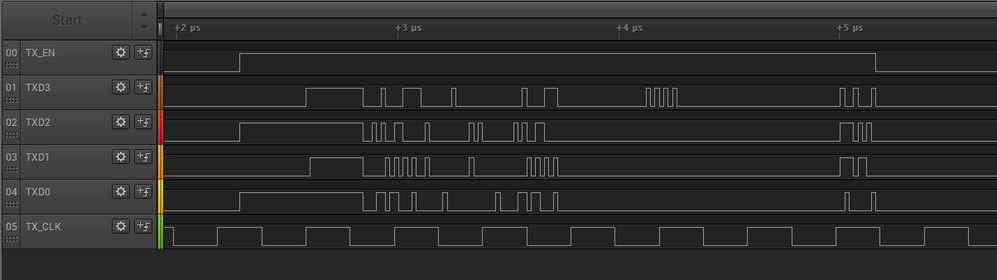

I'm using a Toradex Colibri iMX6ULL SoM and am having some issues with getting ethernet to work. The Toradex module has a Microchip KSZ8041 PHY on board, which is connected to ENET2 via RMII and MDIO and works without issues.
I'm attempting to connect a Microchip KSZ8463 switch to ENET1 via MII and SPI. So far I'm only able to receive data on the CPU and when attempting to transmit nothing shows up on the network and reading the switch statistics suggests it's just receiving garbage data from the CPU.

When this didn't work, I changed the two fixed-link entries to 10mbit full-duplex and changed some registers in the KSZ8463 to switch to the same mode. As a result both the TX and RX clocks generated by the KSZ8463 went from 25MHz to 2.5MHz as expected, but transmitting still does not work while receiving works fine.
However, after doing this I noticed the following:
While you can see the TX_CLK has gone to 2.5MHz, somehow the data is being clocked at the original 25MHz while I think it's supposed to be clocked on the edge of the TX_CLK? My suspicion is that the same is happening at the original 100mbit and the data is being clocked out on the wrong clock somehow? The original umx6ull.dtsi does include some clock options but I'm not entirely sure what I should be overriding in this case:

Hi Igor,
The problem turned out to be the iMX6ULL MAC generating it's own tx_clk signal, solved by changing the ENET1_TX_CLK_DIR and ENET1_CLK_ SEL bits in the GPR1 register.
