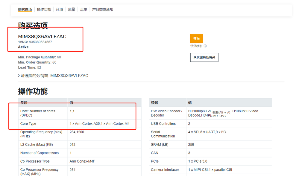

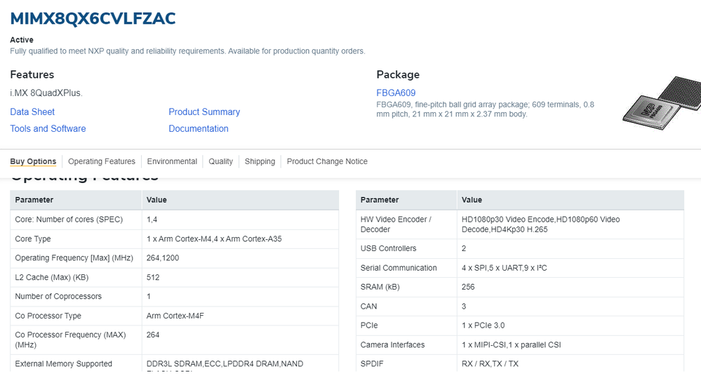

Hello, today, I find the MIMX8QX6AVLFZAC is 1x core A35; MIMX8QX6CVLFZAC is 4x core A35,, But I see the some file show the both of  MIMX8QX6AVLFZAC and MIMX8QX6CVLFZAC is 4x core A35. please tell me what is ture?
 微信图片_20220324151502.png微信图片_20220324151502.png微信图片_20220324151516.png微信图片_20220324151516.png
1 返信
1,022件の閲覧回数
Rita_Wang
 4 x Cortex-A35 is ture. MIMX8QX6CVLFZAC Q means 4 cores.
2 x Cortex-A35
(i.MX 8DualXPlus)
4 x Cortex-A35
(i.MX 8QuadXPlus)
