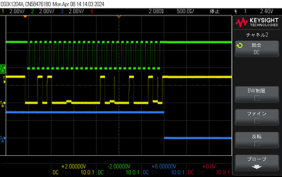

An error occurs when poweroff on our board that uses i.MX 7Dual.
I am using i2c for poweroff.
I have attached images of the waveforms when normal and when an error occurs.
* normal
* error
green: SCL
yellow: SDA
blue: power
When an error occurs, it appears that the i.MX 7D is outputting an abnormal SCL.
(It is low for only 2μ seconds.)
It seems like that's why i2c devices can't release SDA.
Do you know of any similar cases?

In conclusion, increasing the timeout of i2c_imx_trx_complete() solved the problem. It seems that 1100us is not enough when the slave causes clock stretching.
After that, an error occurred in i2c_smbus_write_byte_data() for poweroff, but it was fixed by making the same changes as below.
https://github.com/torvalds/linux/commit/f8ee39b44b75ac955bb54f46d5370481727c47e7
