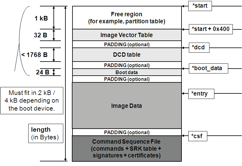

I try to authenticate a encrypted image with 'hab_auth_image'.
This is working perfectly when I have the IVT in memory behind the encrypted binary. Now I want to have it at offset 0, so I don't need to change anything in u-boot configuration when the images changes.
Is this generally possible ?

When I try to authenticate the image I get:
=> ext4load usb 0:1 0x12000000 zImage_encblob
6754376 bytes read in 271 ms (23.8 MiB/s)
=> hab_auth_img 0x12000000 0
Authenticate image from DDR location 0x12000000...
Secure boot enabled
HAB Configuration: 0xcc, HAB State: 0x99
--------- HAB Event 1 -----------------
event data:
        0xdb 0x00 0x08 0x41 0x33 0x22 0x0a 0x00
STS = HAB_FAILURE (0x33)
RSN = HAB_INV_ADDRESS (0x22)
CTX = HAB_CTX_AUTHENTICATE (0x0A)
ENG = HAB_ENG_ANY (0x00)
Is there any need for a new DCD when I have the IVT before the encrypted image ?
I have no problems with the other layout, so it can't be a problem of keys or hardware-configuration.
My device is closed and the u-boot is signed correct.

  You may look at Figure 1 (Typical memory layout of a signed image) of app note AN4581, Rev. 1, 10/2015.
  All shown data structures, from free region (partition table for instance) till
Command Sequence File (commands + SRK table +signatures + certificates)
must be signed with a digital signature. Image Vector Table has 0x400 offset.
  As for encrypted boot:  sorry, but this information  is treated as confidential info at this time
and requires a signed NDA (Non-Disclosure Agreement). We cannot discuss this with you in public anyway,
this requires to be handled as a Service Request (SR). Be aware that to give you remote support through a SR,
we will still need the confirmation that the NDA is in place.
