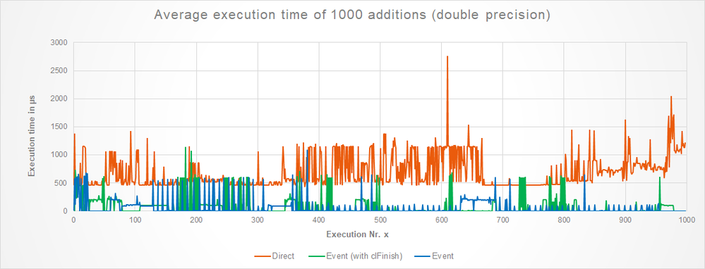

peter_eberl
Bio_TICFSL‌
The graph shows the kernel execution times of a simple vector-vector additions with vector size 1000.
The addition was executed 1000 times.
My problem is the variance of values:
Min. exec. time:  2E-6 seconds
Max exec. time:  9.61E-4 seconds
Median:              9E-5 seconds
Even with 10E4 executions the max exec. times vary to around 2ms.
Execution Values are extracted through clGetEventProfilingInf() method (end-start timestamps).
Questions:
What causes this extreme variance of ~500%?
Is yocto linux a real-time operation system? -> Are possibly interrupts a cause of delay of enqueueing?
Am i measuring the timestamps correctly?
