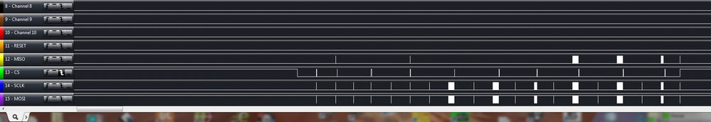

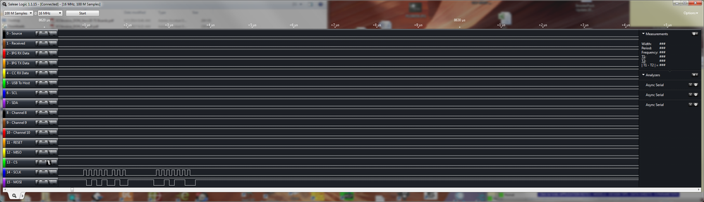

I am struggling with an spi issue on imx6ul.
Any pointer will be helpful to fix / debug this issue
When I trace the SPI line, it seems that there us a drift in CS line, Also on clk line there are sometime 7 pulses and sometime 8 pulses.
Below is my device tree setting
What do you mean by that? "Drifting" in level up and down or time early and late? You can expect a lot of variation in time as they're being driven as GPIOs in software. In this post there's a clock glitch, and sometimes I think it said the chip-select was too late and happened after the eCSPI had started clocking:
https://community.nxp.com/thread/386935#comment-625531
The "7 or 8 pulses" is just plain weird. something seriously wrong there.

Hi Anand
one can check ECSPIx_CONREG[BURST_LENGTH] value described in
sect.20.7.3 Control Register (ECSPIx_CONREG) i.MX6UL Reference Manual
and that during transmitting burst fifo was not empty.
http://cache.freescale.com/files/32bit/doc/ref_manual/IMX6ULRM.pdf
igor
