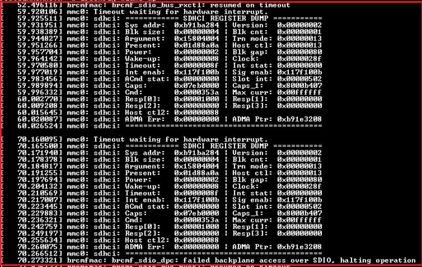

iMX8MM dropping SDIO clock to 12MHz causes the SDHCI crash
[  641.123790] mmc0: sdhci: ============ SDHCI REGISTER DUMP ===========
[  641.130232] mmc0: sdhci: Sys addr:  0x54968d04 | Version:  0x00000002
[  641.136671] mmc0: sdhci: Blk size:  0x00000004 | Blk cnt:  0x00000001
[  641.143110] mmc0: sdhci: Argument:  0x15804004 | Trn mode: 0x00000013
[  641.149548] mmc0: sdhci: Present:   0x01d88a0a | Host ctl: 0x00000013
[  641.155986] mmc0: sdhci: Power:     0x00000002 | Blk gap:  0x00000080
[  641.162425] mmc0: sdhci: Wake-up:   0x00000008 | Clock:    0x0000028f
[  641.168863] mmc0: sdhci: Timeout:   0x0000008f | Int stat: 0x00000000
[  641.175301] mmc0: sdhci: Int enab:  0x107f100b | Sig enab: 0x107f100b
[  641.181739] mmc0: sdhci: AC12 err:  0x00000000 | Slot int: 0x00000502
[  641.188178] mmc0: sdhci: Caps:      0x07eb0000 | Caps_1:   0x8000b407
[  641.194616] mmc0: sdhci: Cmd:       0x0000353a | Max curr: 0x00ffffff
[  641.201054] mmc0: sdhci: Resp[0]:   0x00001000 | Resp[1]:  0x00000000
[  641.207492] mmc0: sdhci: Resp[2]:   0x00000000 | Resp[3]:  0x00000000
[  641.213930] mmc0: sdhci: Host ctl2: 0x00000088
[  641.218372] mmc0: sdhci: ADMA Err:  0x00000000 | ADMA Ptr: 0x5608d208
[  641.224809] mmc0: sdhci: ============================================
NXP team, can someone point to what could be the reason

Actually you should see it on both, our recent test was run on imx8mnevk board with L5.4.3 BSP where we saw this issue. So, the problem is reproducible using either of the boards.

ramesh_r
Hi Rita,
This same test was run on using NXP's L5.4.3 BSP release and the problem is still observed. When the mmc clock is changed to 12Mhz, this message is observed with a dump:
Timeout waiting for hardware interrupt
drivers/mmc/host/sdhci.c:sdhci_timeout_data_timer <== Here is the source & function. Attaching a screenshot for ref.
