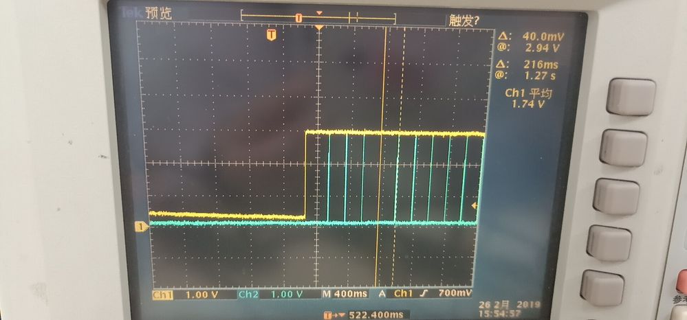

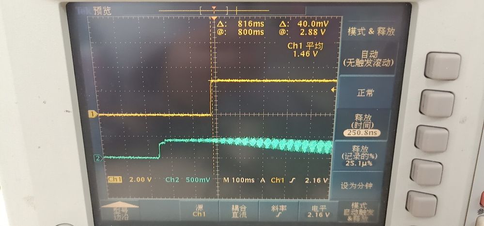

When the system is powered up abnormally, the waveforms of VSNVS_3V0 and PWRON are as follows.
When the system is powered up normally, the waveforms of VSNVS_3V0 and PWRON are as follows
The yellow waveform is VSNVS_3V0
the PWRON SIGNAL AND 32K  XI signal
I made three boards, one of which works fine no matter how the power is turned on.The other one, VGEN3_2V8 will flash when the power is first turned on, but if it is powered on quickly after power off, the power will work normally.I really don’t know why, do you have any thoughts?

reyes
I have never seen this behavior before in application with no camera of other video source connected.
Since your issue is intermittent and not affecting all your boards, I’m thinking that the problem is not caused by a circuit or layout design, but it could be associated with a problem during the manufacture and/or solderability of the boards.
Have you tried to perform a swap test by changing the PMIC from a “good board” (or a new PMIC) to a “failing board” to see if this solves the problem of the failing board? This would confirm if the problem is the PMIC or the board itself.
Make sure the PMIC is properly soldered under the criteria below, otherwise the PMIC could be suffering damage while soldering.
