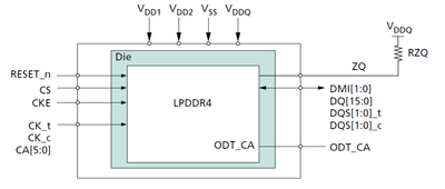

What are your thoughts on Kingston D1611PM3BDGUI-U. It is very similar to C1612PM1WDGTK-U which is used on the EVK except that the configuration is 128Mb x 1 rank(s) x 8 banks x 16 DQ x 1 channel instead of 64Mb x 2 rank(s) x 8 banks x 16 DQ x 1 channel. Below is the block diagrams of the proposed single rank DRAM and the obsolete dual-rank DRAM:
I could use a similar routing, except I would disconnect CS1_A, CKE1_A and ZQ1. Or I could keep them connected in case I want to drop in a dual rank configuration in the future. Please let me know what you think.
