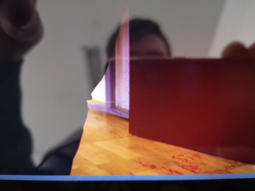

We are working with a modified version of the imx6q-apalis-eval.dtb. Our System is running fine but we recently needed to switch to a new Touch Display: https://www.telerex-europe.com/content/files/pdfs/productPdfs/POW/PH102600T009-IBC03.pdf
We have some Issues with the Displays Colors... there are strange stripes in our Colors and sometimes there are appearing purple pixels on screen.
I Modified the Device Tree Files like this:

vidargs are:
vidargs=video=mxcfb0:dev=ldb,if=RGB24,bpp=32 ldb=sin0 video=mxcfb1:off video=mxcfb2:off video=mxcfb3:off fbmem=32M
I managed to catch the issue on my phone... i cant think of a better way to send you a image of the issue... but u can clearly see the stripes, the purple pixels and the red pixels. ... this is just a picture of the floor, a red door in the background and a part of my leg... the image is displayed on our software.
I think these are the relevant parts... I tried to modify the interface_pix_fmt values and set it to something else.. but no success... maybe my display timings are off?... I cant find any relevant display timing data in that data sheet. Can somebody help me maybe?

Hi George
apalis board was developed and supported by toradex, it may be posted on its forum:
Welcome to - Toradex Community
Among other things may be useful to check bootargs: "if=RGB24" in one place and RGB666 in dts file.
