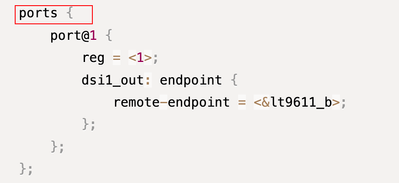

We use lt9611 to convert MIPI DSI to HDMI but I got a build error while bitbake.
As I following the reference from https://community.nxp.com/t5/i-MX-Processors/IMx93-uses-lt9611-chip-to-convert-MIPI-into-DSI-without... , I got a bitbake error as below:
ERROR (phandle_references): /soc@0/dsi@4ae10000/ports/port@1/endpoint: Reference to non-existent node or label "lt9611_b
And I already configured DRM_LONTIUM_LT9611=y in defconfig.
Here is the definitions in the device tree (imx93-11x11-evk.dts).

&dsi {
	status = "okay";
	ports {
		port@1 {
			reg = <1>;
			dsi1_out: endpoint {
				remote-endpoint = <&lt9611_b>;
I hope everyone can give me some suggestions. Thanks.

Hi @AlanWen
You can try to remove this property.
1,565 Views
AlanWen
But it turns out into an
Error(duplicate_label): /soc@0/dsi@4ae10000/port@1/endpoint: Duplicate label 'dsi1_out' on /soc@0/dsi@4ae10000/port@1/endpoint and /soc@0/dsi@4ae10000/ports/port@1/endpoint
I had solved the problem by putting the lt9611: hdmi@3b device tree from lpi2c1 to lpi2c3
But the device could not work on the board, maybe there is still something wrong.
Now it can only build without error message.
