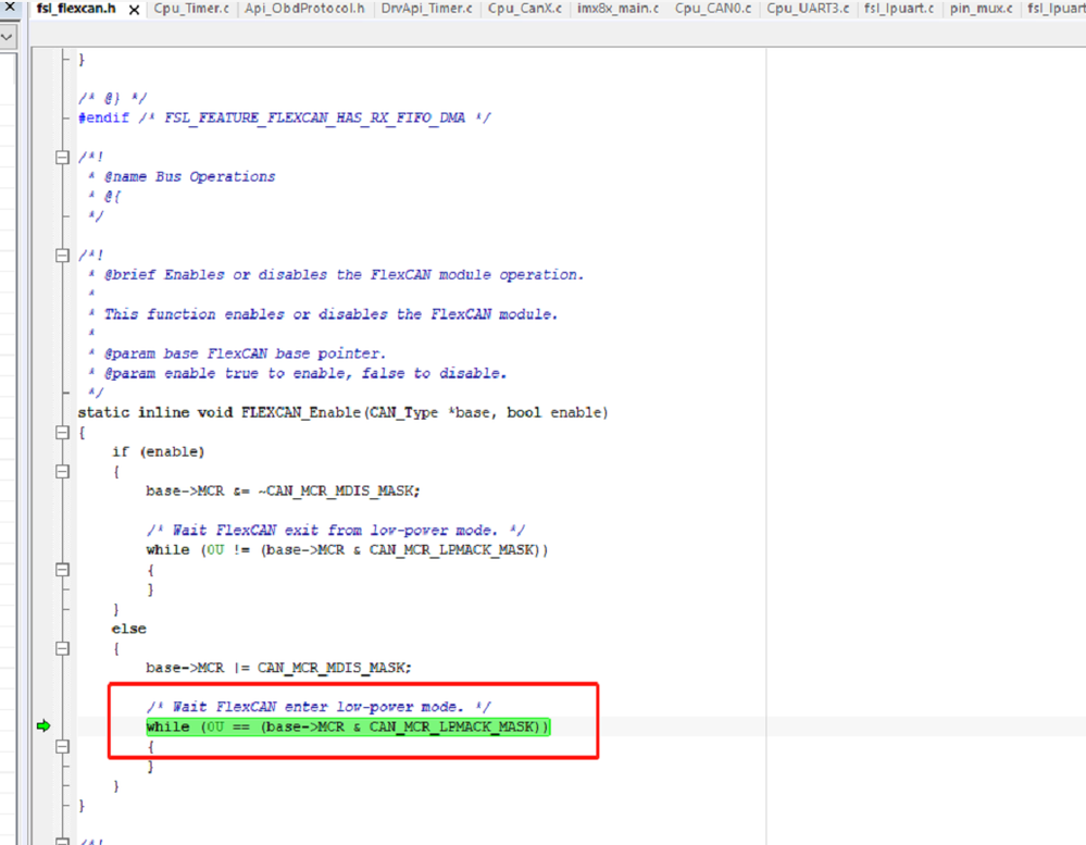

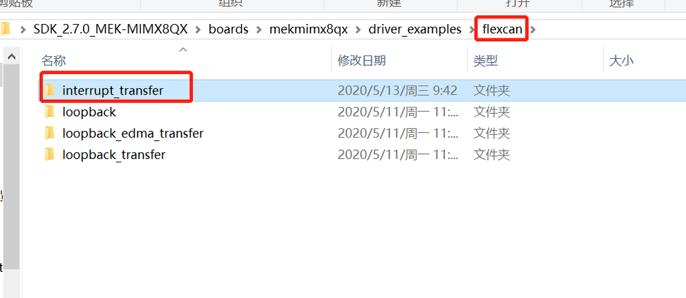

   近期我们在调试i.MX 8QXP MEK的M4内核,正在调试FLEXCAN的功能。使用的是SDK_2.7.0_MEK-MIMX8QX\boards\mekmimx8qx\driver_examples\flexcan\interrupt_transfer程序。pastedImage_2.png
例程使用的是CAN0,我们将CAN0相关配置改成CAN1后,发现CAN1无法使用,初始化的时候会卡死在初始化函数里,如下图:
经过各种尝试发现一定要将CAN0先初始化,CAN1才能正常初始化和使用,不知道为何需要这样? 您这边是否能提供一个CAN1的使用例程呢,非常感谢!

The flexcan on 8QX is implemented as below :
  • Power domain of CAN1/CAN2 is the child domain of CAN0's
  • FlexCAN0,CAN1/CAN2 share the clock root, SCFW provides CAN0 clock control list(interface) only to enable or disable the clock.
So
  • when use CAN1/CAN2 you need to power on CAN0 as well, take CAN1 for exampe :
    if (sc_pm_set_resource_power_mode(ipc, SC_R_CAN_0, SC_PM_PW_MODE_ON) != SC_ERR_NONE)
        PRINTF("Error: Failed to power on FLEXCAN0\r\n");
        if (sc_pm_set_resource_power_mode(ipc, SC_R_CAN_1, SC_PM_PW_MODE_ON) != SC_ERR_NONE)
        PRINTF("Error: Failed to power on FLEXCAN1\r\n");
  • Flexcan clock table should all set to CAN0 in fsl_clock.h as below , as scfw only provides control interface for CAN0, the new package for 8QX will be available soon with the patch.
#define FLEXCAN_CLOCKS                                     \
        kCLOCK_DMA_Can0, kCLOCK_DMA_Can0, kCLOCK_DMA_Can0, \
   Please have a try.

I believe the issue here is there is only a single clock that feeds all three CAN modules (SC_R_CAN_0), in the SDK when you call -
/* Power on Peripherals. */
PRINTF("Error: Failed to power on FLEXCAN\r\n");
This will enable the clock as well, but if you use SC_R_CAN_1, I don't believe the clock will get enabled, which also explains why when you initialize CAN_0, CAN_1 then works.
The fix is calling the above for both SC_R_CAN_0 and SC_R_CAN_1 should work, in order to use any of the CAN modules a call to CAN_0 will be needed.
