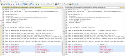

I am working with IMXRT1062 and facing issue with flex SPI  nor flash API There are 2 scenarios one is working and other is not working. made changes in .icf file after increasing the bin size we changed  m_data_start to m_data2_start.
Working - In this scenario  my bin size is less then 80k  .icf file for this is MIMXRT1062xxxxx_flexspi_nor.icf(working with this .icf file)
Not Working - In this scenario my bin size is 200k so that changed my .icf file  MIMXRT1062xxxxx_flexspi_nor_1.icf file in attachment.
The only change in code is we are using different MIMXRT1062xxxxx_flexspi_nor.icf file
i am attaching the both .icf file

I checked your attached icf, you just do the DATA region change:
Do you want to use this RAM?
define symbol m_data2_start = 0x20200000;
define symbol m_data2_end = 0x202BFFFF;

Issue seems after change in MIMXRT1062xxxxx_flexspi_nor.icf RAM section from m_data to m_data2. because when i was using m_data section it was able to flash 32k data in loop but after changing to m_data2 not able to flash complete some times Stucks on
flexspi_nor_enable_quad_mode(FLEXSPI);
In previous code we used to use m_data_start(ITCM) space now using m_data2 space because of linker issue insufficient memory for global data and also if we are increasing the m_data_end code is going for hard fault.
I am suspecting, my issue is relevant to below link
Using NonCached Memory on i.MXRT - NXP Community
please suggest what scenarios effect to external flash R/W after change of m_data RAM section  to m_data2 in .icf file

  You mentioned: Issue seems after change in MIMXRT1062xxxxx_flexspi_nor.icf RAM section from m_data to m_data2
 m_data is the DTCM, m_data2 is the OCRAM.
  Do you enable the cache or not? You can try to disable the cache, whether it have improvement or not, as the TCM won't be influenced by the cache, but the OCRAM will.
 You also mentioned:In previous code we used to use m_data_start(ITCM) space now using m_data2 space because of linker issue insufficient memory for global data and also if we are increasing the m_data_end code is going for hard fault.
Do you already try to modify the flexRAM with higher TCM data size? Normorally, it needs to reallocated the flexRAM.
You can refer to this application note:
https://www.nxp.com/docs/en/application-note/AN12077.pdf
If you still have issues about it, please kindly let me know.
