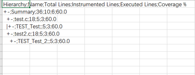

After successfully executing the Gcov code coverage on "hello_world" example from i.MXRT1170 SDK (2.10.1 version).
Try to generate gcov code coverage data into ".csv" format from mcuexpresso IDE.
But It's showing below error.
Error: An internal error occurred during: "Export to CSV".
java.lang.IllegalArgumentException (screenshot attached)

jeremyzhou
Maybe you can try to use the gcovr tool to generate the csv from the raw coverage file.

jeremyzhou
I basically replicate the issue you mentioned.
However, the CSV file can be generated even with the error.
