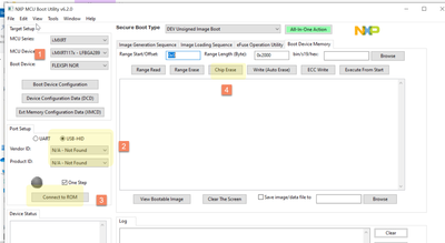

1.  Board power off, then SW1 : 1-off,2-off,3-off,4-on
2. Find another USB cable, connect to the J20
3. power on the board.
4. open the MCUbootutility tool:
https://github.com/JayHeng/NXP-MCUBootUtility/releases/tag/v6.2.0
the related user manual is:
Use the mcubootutility to do the mass erase:
After the erase finished, then can switch the SW1 back to internal boot mode, SW1:1-OFF,2-OFF,3-ON, 4-OFF, then use the on board CMSIS DAP download the code in the mcuxpresso IDE again.

I set SW1 in serial mode but it's not working.
