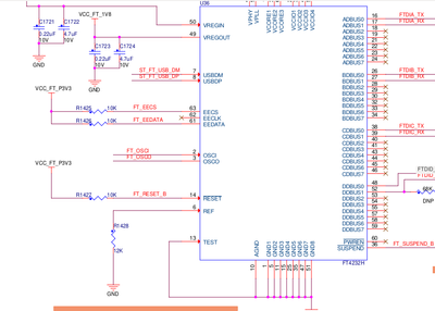

I am currently working on IMX8QXP-MEK, and I have some queries regarding the debugging methods. I am a newbie to this platform. From the NXP documents, I came to know that there are mainly two methods to debug i.MX8. One is UART, and the second one is JTAG.
When the EVK is connected to the PC via USB, there are 4 UART ports visible: /dev/ttyUSB0, /dev/ttyUSB1, /dev/ttyUSB2, and /dev/ttyUSB3. Cortex A35 prints [Linux] can be seen over /dev/ttyUSB0, and M4 Cortex prints can be seen over /dev/ttyUSB2.
I am a little bit confused about which UART (among FTDIA, FTD_IB, FTDIC, FTDID ) is connected to Cortex A35 and Cortex M4 debugging.UART Connection diagram  of EVK is shown below.an JTAG be used for debugging both M4 and A35? Or can M4 only be debugged using JTAG? Kindly help me to resolve my doubts.

You can see 4 ports when you connect the board to your board because the UART to USB bridge supports 4 ports (only 3 are connected to the board).
By default using our bsp and examples the cores can be debugged as you mention "Cortex A35 prints [Linux] can be seen over /dev/ttyUSB0, and M4 Cortex prints can be seen over /dev/ttyUSB2" but in really you can use any uart for each core, but I recommend to use the default configuration because the changes and configurations to change the debug uart port are a little difficult.
The JTAG connector can be used to debug both cores normally we debug only the M core with the JTAG connector, but using tools like Lauterbach you can debug any core on the chip.
