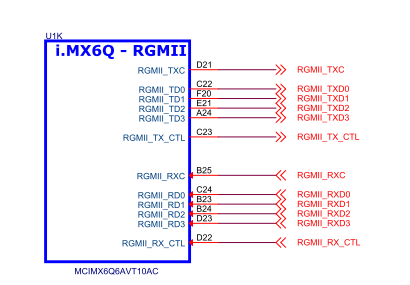

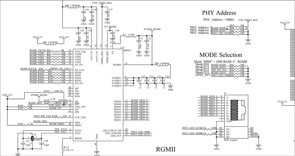

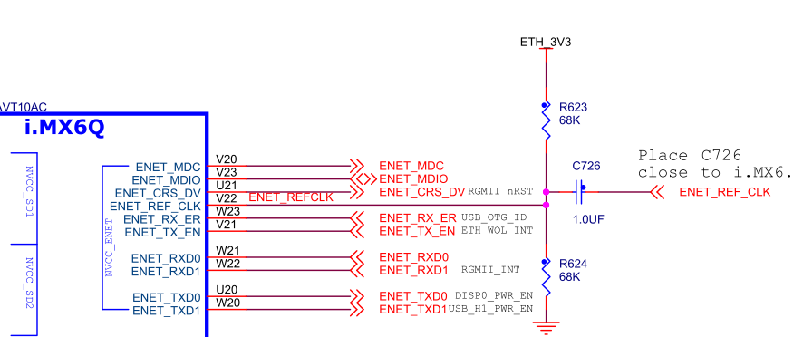

   The diagram of i.MX6Q board is as follow.

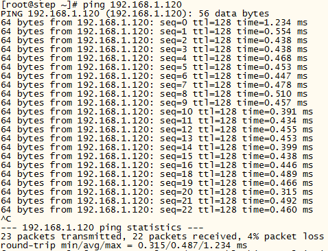

   Packet loss is as follow.

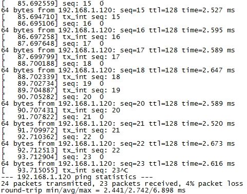

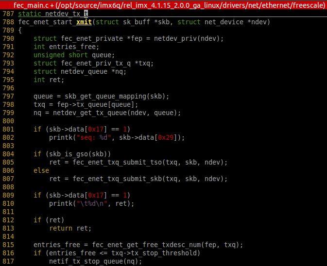

yanfali
Hi igorpadykov,
It doesn't work.
I am not sure that the bug which causes packet loss exists in MAC driver or PHY driver.
In order to confirm that there is no bug in MAC driver, so I modify MAC driver.
In fec_enet_start_xmit function,  when icmp datagram is transmitted, print the sequence of icmp datagram.
And print the return value of fec_enet_start_xmit function.
In transmition completion fec_enet_tx_queue function, I also print the sequence of icmp datagram.
Reboot linux.
Ping PC which ip is 192.168.1.120, and capture datagram using wireshark on PC.
The result of ping is as follows.
