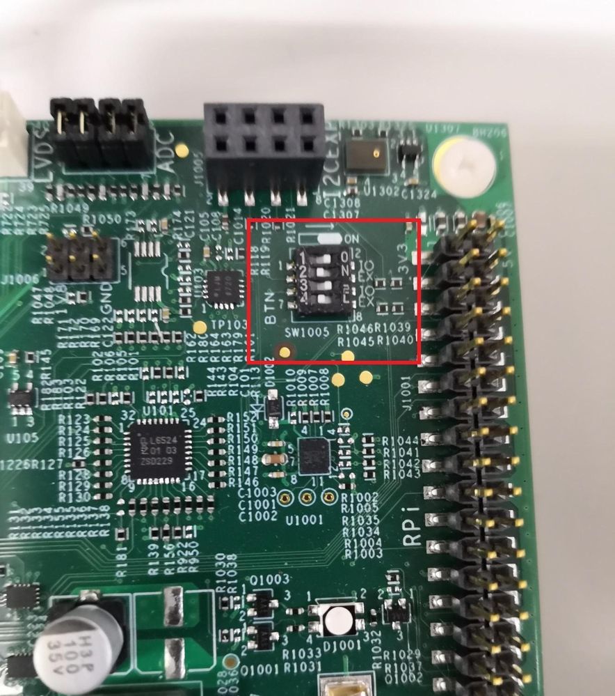

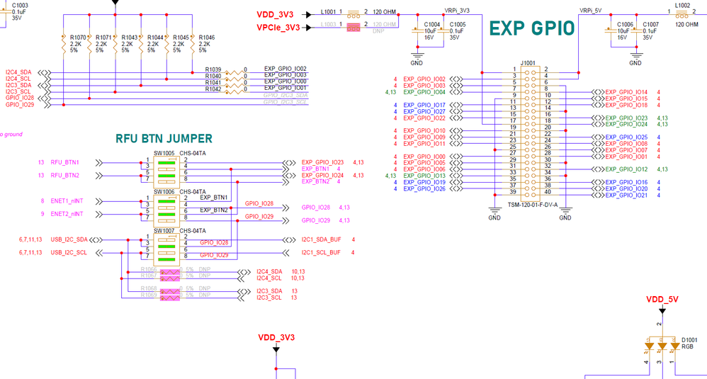

On the i.MX93 EVK board, there are two buttons BTN1 and BTN2. They are connected to GPIO IO23 and GPIO IO24. Below is the schematic.
 Buttons on the board.
 SW1005 on the board

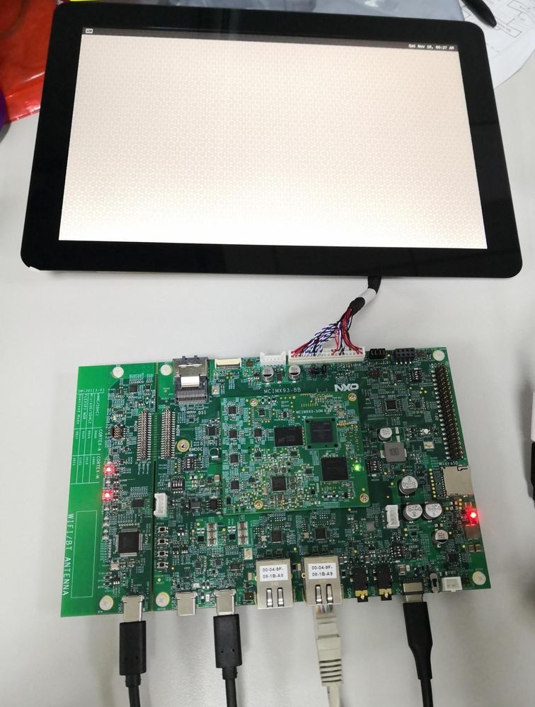

Connect the LVDS to the board. Use the corresponding dtb to boot the board. In u-boot, set the dtb file.
=> setenv fdtfile imx93-11x11-evk-boe-wxga-lvds-panel.dtb
=> saveenv
Then restart the board. After the board boot up, it will look like below.
You need to calibrate the LVDS touch screen before it can normally use. Please use this command:

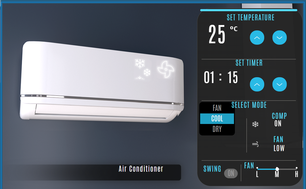

Now, build the GUI guider example. I use the Air Conditioner example.
Download the GUI guider from the gui-guider web page:
https://www.nxp.com/design/software/development-software/gui-guider:GUI-GUIDER
Follow the steps from the below web page to build the i.MX BSP and the gui example code.
https://docs.nxp.com/bundle/GUIGUIDERUG-1.6.1/page/topics/yocto.html
After the gui-guider build completed, use the 'scp' command to transfer the gui_guider executable file to the board. Execute the command on your host PC like this:
$ scp bld-imx93evk/tmp/work/armv8a-poky-linux/gui-guider/1.6.0-r0/image/usr/bin/gui_guider root@<Your Board IP address>:/
Note: You could use a router to connect your board and your host PC. They are on the same network so could use the 'scp' command to transfer the file to your board.
On your board, type the following commands to execute the gui.
$ chmod 755 gui_guider
$ ./gui_guider &

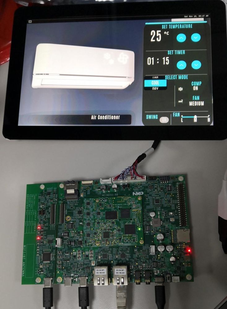

Then the GUI is running like this:

Finally, you can use the buttons on the EVK board to set the temperature up and down.
