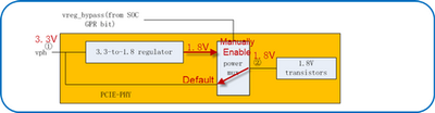

The PCIE_VPH power supply is selectable in software  between 1.8V and 3.3V. When the PCIE_VPH supply is configured to operate at 3.3V, the 1.8V internal regulator (disabled by default) must be enabled to prevent overstress conditions on the PCIe PHY. If the 1.8V internal regulator is left disabled when the PCIE_VPH supply is configured to operate at 3.3V, it could potentially impact the product lifetime of the device.

•When the PCIE_VPH supply is configured to operate at 3.3V users need to enable the internal regulator by setting the IOMUXC_GPR_GPR14 and IOMUXC_GPR_GPR16 registers - PCIE1_VREG_BYPASS and PCIE2_VREG_BYPASS bit to 0.

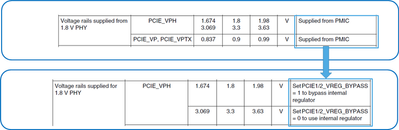

Documentation Change Description – 1 of 3 for Datasheet
Updated Datasheets and Reference Manual will be published to nxp.com.
Updated Hardware Design guide and Schematics have already been published on nxp.com.
Updated the descriptions of PCIE_VPH in the Datasheet Table 8, "Operating ranges"

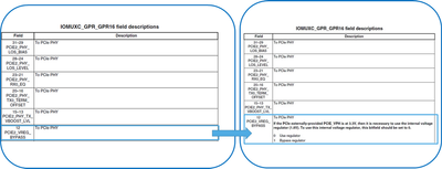

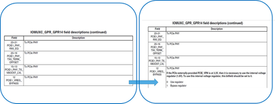

Updated the description of field 12 "PCIE1_VREG_BYPASS" in 8.2.4.15 GPR14 General Purpose Register (IOMUXC_GPR_GPR14)
Documentation Change Description – 3 of 3 for RM
Updated the description of field 12 "PCIE2_VREG_BYPASS" in 8.2.4.17 GPR16 General Purpose Register (IOMUXC_GPR_GPR16)
