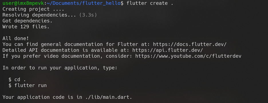

4. Run the command “flutter create .” to create a flutter project, this framework will create different folders and files used to develop the application.
$ cd Documents
$ mkdir flutter_hello
$ cd flutter_hello
$ flutter create .​

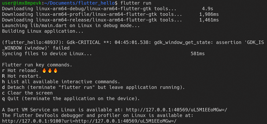

5. Finally, you can run the “hello world” application using:
$ flutter run
Verify the program behavior incrementing the number displayed on the window.
