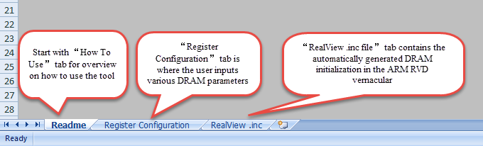

1\DRAM Register Programming aid
Our expert team create the script to make it easier to work on DDR initialization.
You can see all the scripts on different chips and the link is:
i.MX Design&Tool Lists
The script include 3 sections, when you open it you can see the details.
Run basic DDR initialization and test memory and open a debugger memory window pointing to the DDR memory map starting address. Try writing a few words and verify if they can be read correctly. If not, re-check the DDR initialization sequence and if the DDR has been correctly soldered onto the board. It is also recommended to re-check the schematic to ensure the DDR memory has been connected to the SoC correctly. In some cases, a DRAM calibration routine may need to be executed.
About the details use and introduction on this script you can refer to
Freescale i.MX6 DRAM Port Application Guide-DDR3
