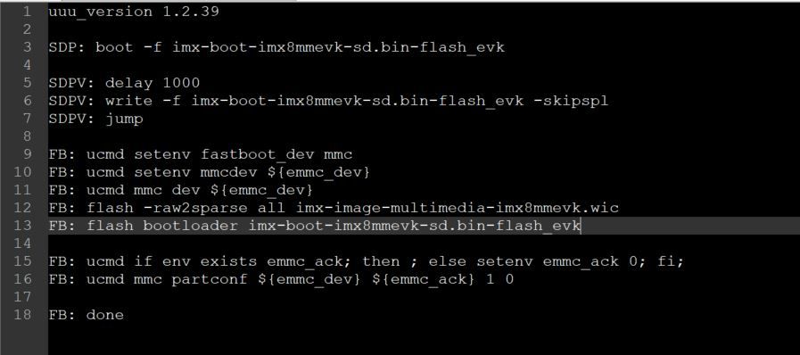

The very first line of the script must be the version number which will represent the minimum UUU version that UUU can parse this script. For this case that version is 1.2.39
After it, we will add all standard commands to flash uboot and filesystem into the eMMC.
Note: This may be also copied from the uuu.auto script inside the Demo files.
Please note that the UUU commands format is PROTOCOL: CMD, for this example we will be using mainly SDP and FB protocols which corresponds to the serial download protocol and Fastboot respectively.

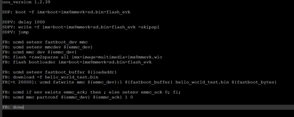

The script will look as following:
If the script is run now uboot (imx-boot-imx8mmevk-sd.bin-flash_evk), rootfs (imx-image-multimedia-imx8mmevk.wic) will be flashed and the Cortex-M binary (hello_world_test.bin) written to the FAT partition of the eMMC.

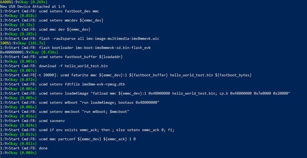

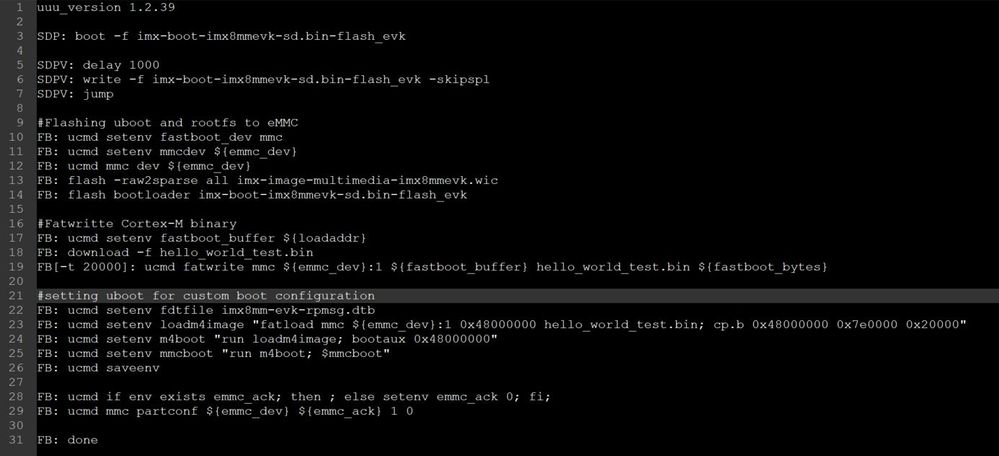

The resulting script will be the following:
Now just save the script and name it as you see fit, for this example the name will be custom_script.auto.
Running the script

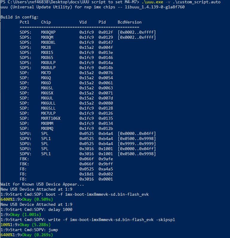

To run a UUU script is pretty simple, just make sure that the files used in the script are in the same folder as the script.
Windows
> .\uuu.exe  custom_script.auto
Linux
$ sudo ./uuu custom_script.auto
Wait till it finish, turn the board off, set it to boot from eMMC and turn it on, the EVK will boot into Linux automatically and will launch the Cortex-M core automatically.

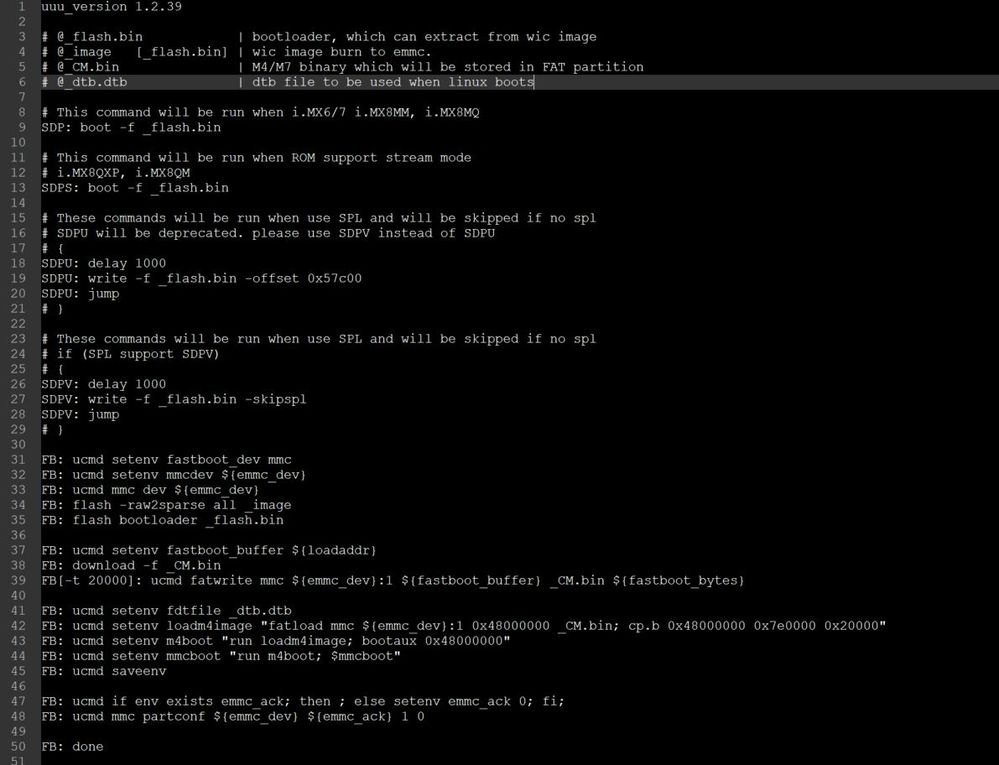

UUU scripts can be customized even more, for example using macros, so the script can take input arguments so it may be possible to select the uboot, rootfs, Cortex-M binary and dtb to be used when booting, and to be used for other i.MX chips as well.
The resulting script will be as following:
Note: Here is assumed that the dtb file is already at the FAT partition, if not same procedure may be added as the Cortex-M binary.

> .\uuu.exe -b uuu_cortexM_loader.auto imx-boot-imx8mmevk-sd.bin-flash_evk imx-image-multimedia-imx8mmevk.wic hello_world_test.bin imx8mm-evk-rpmsg.dtb
Linux
$ sudo ./uuu -b uuu_cortexM_loader.auto imx-boot-imx8mmevk-sd.bin-flash_evk imx-image-multimedia-imx8mmevk.wic hello_world_test.bin imx8mm-evk-rpmsg.dtb
Please find both UUU scripts attached and feel free to use them. Hope this helps everyone to better understand how this tool works and the capabilities it have.
