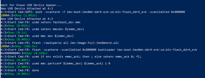

After this we can download our uboot image to our board, we can either use the uboot image for boot or for flashing purpose only.
We can compare the time it takes using UUU with a standard pre-built image
uuu -V -b emmc_all imx-boot-imx8mn-ddr4-evk-sd.bin-flash_ddr4_evk imx-image-full-imx8mnevk.wic
It takes 485.5 seconds using normal uboot with debug console enabled.

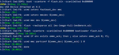

uuu -V -b emmc_all flash.bin imx-image-full-imx8mnevk.wic
It takes 477.5 seconds using silent uboot console.
Even if the speed is not greatly improved (~8 seconds), in larger files it could help to speed up flashing, even if wants to have the console silent is a good option.
