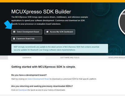

First step would be to get the SDK package, this include documentation and code, which is available at the MCUXpresso builder webpage:
https://mcuxpresso.nxp.com/en/welcome
Click on the select a development board and select the package for your development kit or the i.MX MPU

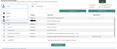

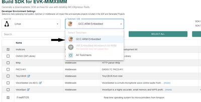

This guide is focused on Linux build so will select GCC package and Linux host PC as the environment.

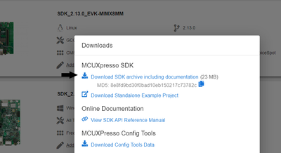

On new window select download SDK
Select on new pop-up window download both SDK and documentation
Read and accept EULA so the download start
