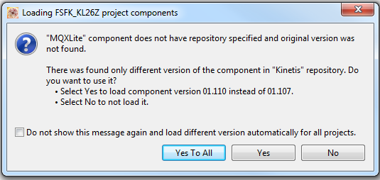

1. Go to File > Import > Existing Projects > Browse > {directory_where_you_extracted_the_sensor_ fusion_library} > {Project}. Ex. FSFK_K64F
2. When you first import a project, a dialog pops up asking if you would like to load a newer component version for MQXLITE, I clicked Yes to All.

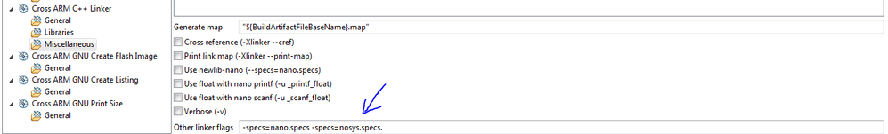

If you try to clean and build the project at this stage, you get an .elf error as the linker can't find nanolibc, even though the Libary search path is set correctly "${ProjDirPath}/Project_Settings/Linker_Files".
3. Right click on the project > Properties > C/C++ Build > Settings > Cross ARM C++ Linker > Miscellaneous > Other linker flags = -specs=nano.specs -specs=nosys.specs.

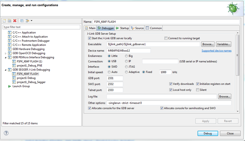

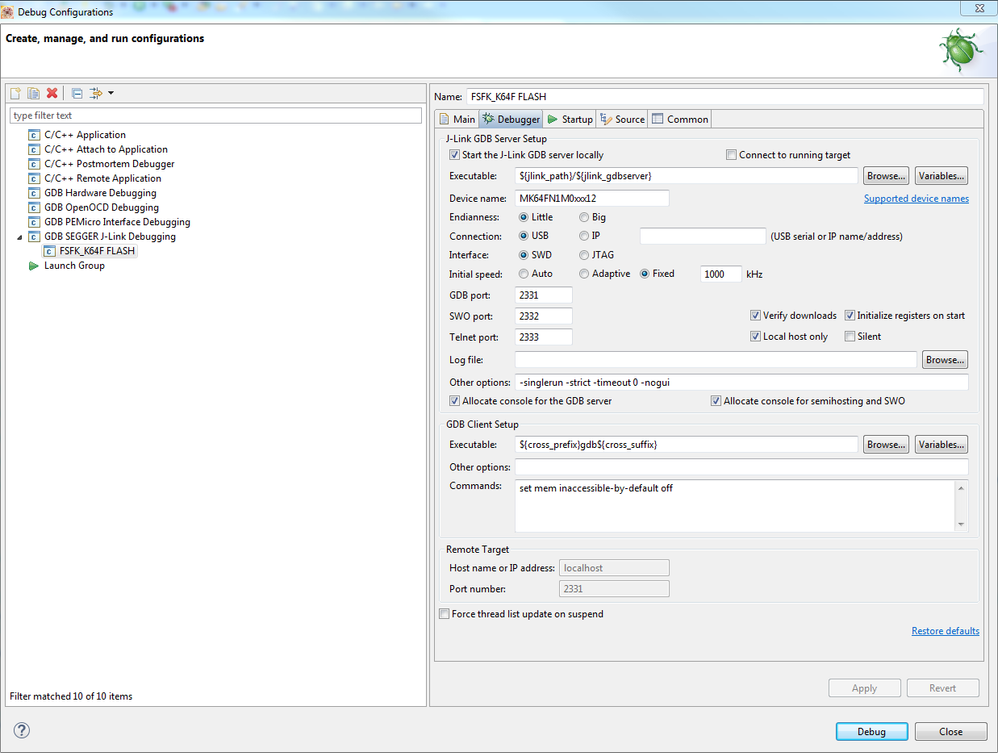

After that the project compiles with a few warnings and you can setup a debug configuration by right clicking on the project > Debug as > Right click on debugger type > New and it should auto-fill the project and C/C++ application, but be sure to specify the right device in the "debugger" tab.
Then hit the Debug and you're away!

I'm glad this posts exists because there isn't much information listed about this the K64F and AGM01 combo. Unfortunately I am encountering a few issues with KDS 3.0.0 with KSDK 1.3.0 and Sensor Fusion Library Build 421. I am running Windows 7 x64 Enterprise Edition. KDS is up to date as of 12/16/15 using the built in updater. I follow all steps that you listed.

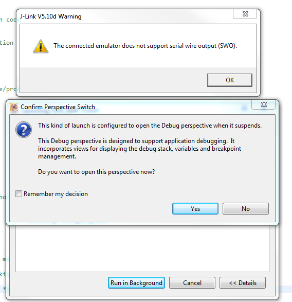

The first issue is that I receive a J-Link V5.10d Warning that states "The connected emulator does not support serial wire output (SWO)." The Sensor Fustion library documentation recommends the Segger solution (https://www.segger.com/opensda.html). I've installed the latest Segger software package, Windows V5.10d, along with the latest bootloader, JLink_OpenSDA_V2_2015-10-13.
My debugging configuration is the default setup matching the screenshot you provided.
I acknowledge the warning and continue to debug. Should I be encountering this error?

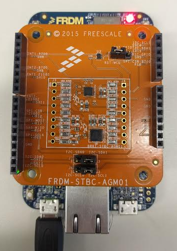

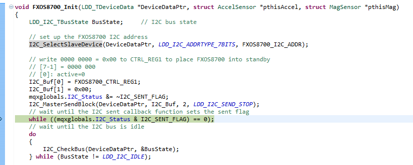

Secondly, what Processor Expert components must be changed to support the FRDM-K64F_AGM01 configuration? The default settings result in the code getting stuck at a while loop in the FXOS8700_Init function. The FRDM-STBC_AGM01 jumpers are set to the default location. Based on your post, it sounds like it should just work as is.

The 4.22 library was published well before the AGM01 board was a gleam in our app's manager's eyes.  It was also before the introduction of KDS3.0.   I HIGHLY suggest you go ahead and upgrade to the 5.00 library.  The latest set of canned projects has everything you'll need to get up and running quickly.  Starting with the FSFK_K64F project, open up build.h and make the following changes:
  • On line 84, set THIS_SHIELD to SHIELD_AGM01 instead of SHIELD_MULTIB
  • Comment out line 96 (#define USE_MPL3115)
then re-generate code using Processor Expert and rebuild.  That should be all it takes.

I still receive the J-Link V5.10d Warning. I don't mind it for now since I can continue development.

You can copy paste that string "-specs=nano.specs -specs=nosys.specs" into the other linker flags box. It builds ok for me, just 2 warnings about an upper I2C limit of 100kHz. I think you made a typo "nanospecs" it should be "nano.specs".

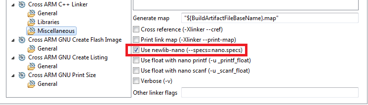

I just thought I would let you know this option as this one works as well.You will get the same results without any errors by just ticking the box (Use newlib-nano (--specs=nano.specs)) which is already there in the "other linker flags" box. See below.
