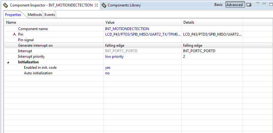

Did you have well configured your INT component? I configure it for Falling Edge interrupt. For pin number, I'm using a FRDM-KL46Z, so it's not the rigth value, yours should be PTC6 (INT1) on FRDM-K46 QRC.
In my Event.c file
void INT_MOTIONDECTECTION_OnInterrupt(LDD_TUserData *UserDataPtr)
  vFXOS8700_OnMotionDetected();
By the end, I have checked the well working of INT with a scope:
Level is normally High. When a motion is detected, There is a falling edge: Interrup is catched by the code and cleared by vFXOS8700_OnMotionDetected() function by reading the FXOS8700 INT_SOURCE register.
I hope it will help you.

I've just tested again my code, (I did  some updates), it works well.
In my FXOS8700.c file:
//!                                Public functions
bool bFXOS8700_Init()
  bool __b_result = FALSE;
  uint8_t __u8_CmdResult = 0;
In my Event.c file
Anthony

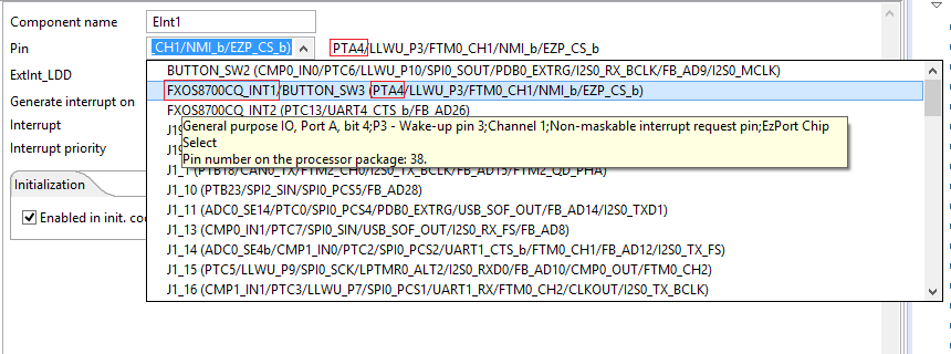

alejandrovelez
Thanks Anthony, I adjusted your code to my needs and it works.
One of the problems that I was having is that there is an error in KDS 3.0 Processor Expert. The pin FXOS8700CQ_INT1 doesn't correspond to the one that is connected to de chip (PTC6).
Regards.
4,956 次查看
anthonyduhamel
Great catch Alejandro.
I will inform the Processor Expert team.
Thanks!
Anthony
