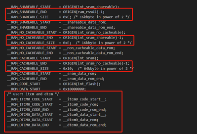

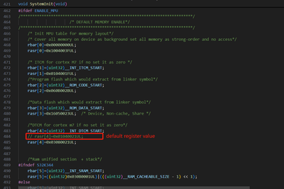

   i use the dtcm as the stack on AutosarOs Task. but i meet the hardfault(Unaligned access UsageFault). i find the SystemInit()  is enable the mpu. but the Privileged Access seems problems.
  i change the rasr[4] value, from 0x01040021UL to 0x03080021UL(refrence to RTD 4.7.0, SW Version 4.0.0), it's work no hardfault. but peripheral(such as: CAN, UART) is not work. it can't send message.
  i use the RTD AUTOSAR 4.4, SW Version 1.0.0.

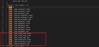

  by the way, i add the section(itcm0_code, dtcm0_data) for use the TCM.
  this problem block me, hoping to get help.
  Attachted the .ld file and MPU code.

and, i change the memory .ld file and add the section, as follow;

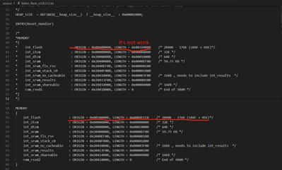

  update the issue:
  i use the boot(start Address:0x0040 0000) + app(start Address:0x0050 0000) projiect. In order to test mpu configuration, i change the app start address from 0x0050 0000 to 0x0040 0000. i find the interrupt not work.
  I use the lasted git code and also changed the start address of the application.  the interrupt also not work.
  so maybe boot cause problems?

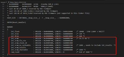

Does the MPU configuration correspond to your current linker file? It sounds like there's some mismatch.

  RTD1.0.0 is the file I am currently testing. I modified the MPU configuration in system.c and the linker script file (ld) based on RTD3.0.0. When the origin(int_flash) in the ld file is set to 0x00400000, the peripherals do not seem to work. However, when I change origin(int_flash) to 0x00500000 and program the BOOT, the system works normally. The DTCM also functions correctly.

  I only changed the flash start address and length of the link file. the periphaerals(can, uart, lin) is not work.
