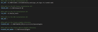

I am using:
SW32K1_RTD_4.4_1.0.1
I want to generate the .elf file using the MCAL in command prompt.
Here's my 'project_parameters.mk' file.
I keep getting this error when using 'make build' command
Thank you in advanced.

Not sure what is the reason for that. Could you try the following change and share with me the log after linking?
Let's see what could be invalid.

Hello @lb28,
Sorry for late reply. Unfortunately, I couldn't reproduce the issue. Could you try to change from slash (\) to backslash (/) in each of the paths and try again? It worked like that in my site:
