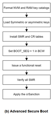

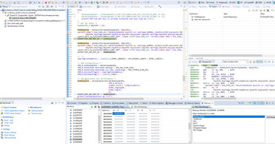

I encountered the following problems when debugging Advanced_SecureBoot Project, please help support.
my project test on s32k312.
1.The Secure Boot CFG result is as follows
2. I change to secure boot by setting BOOT_SEQ
but ,my app can not be boot,Please help analyze the reason, thank you very much
5,579件の閲覧回数
nxf78987
Hello @luhaiou_autolink,
I checked this situation and I detected that the CMAC tag value has not been updated yet at the address 0x584000.
Pass:
Fail:

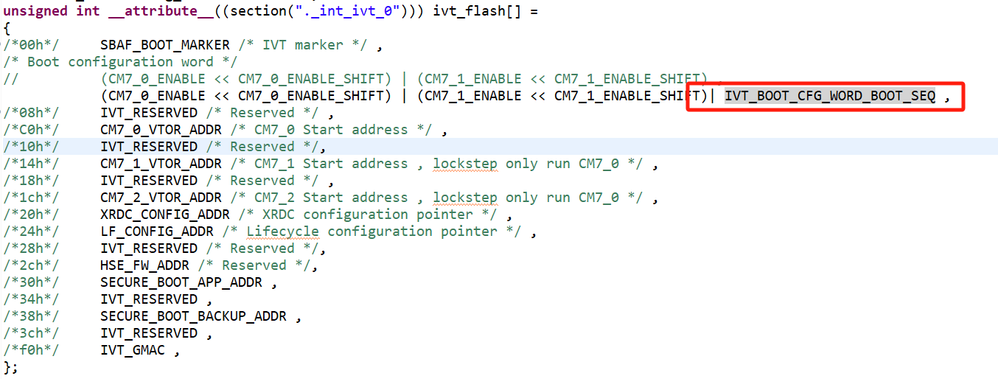

1. Did you define IVT_BOOT_CFG_WORD_BOOT_SEQ correct as below?
    #define IVT_BOOT_CFG_WORD_BOOT_SEQ  (1 << 3)
2. Did you implement Advanced_SecureBootps steps correct?
Dan
6,802件の閲覧回数
luhaiou_autolink
Yes.

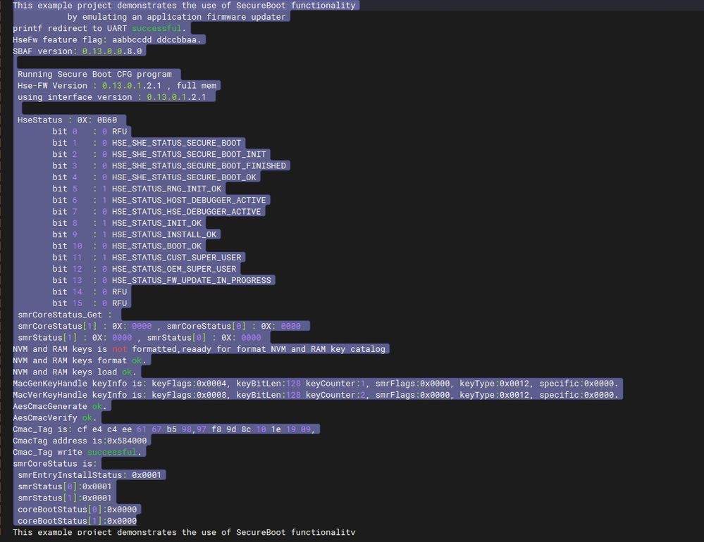

After the Secure Boot configuration was completed, I set the BOOT_SEQ bit and re-downloaded it to the MCU,
but ,my app can not be secure boot.
Each step of the configuration Advanced_SecureBoot has a corresponding log output
You can refer to the main.c .text file.

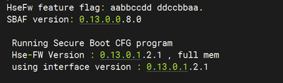

My project was tested on the s32k312,
The versions of HSE_FW and SBAF are shown in the figure below
My demo is based on the following example provided by NXP,
SW745310-SecureBootAppNoteDemo(1.0)
S32K3_HSE_DemoExamples.exe

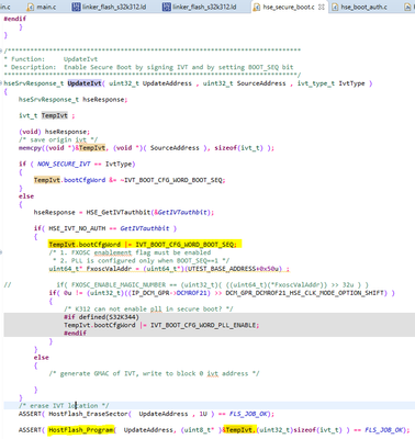

Following the Secure Boot project of NXP, the IVT was updated by code instead of adding IVT_BOOT_CFG_WORD_BOOT_SEQ into the ivt_flash array as your code. And maybe, this caused your program boot to fail.
From my point of view, you should remove IVT_BOOT_CFG_WORD_BOOT_SEQ and update IVT as the sample project of NXP.
Dan
6,706件の閲覧回数
luhaiou_autolink
Thanks for your suggestion,

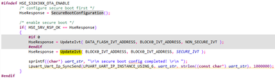

1. I've tried this way, and when modifying the IVT_0,
UpdateIvt( BLOCK0_IVT_ADDRESS, BLOCK0_IVT_ADDRESS, SECURE_IVT ),
this step produces hard_fault, probably the flash access function is restricted when accessing the same FLASH BLOCK.
You can try debugging on the same hardware platform (s32k312), and using the same software platform (SBAF: 0.13.0.0.8.0, HSE_FW: 0.13.0.1.2.1), thank you very much
2.Refer to the demo S32K344_Advanced_SecureBoot in the S32K3_HSE_DemoExamples.exe,
and also does not update the IVT through code, but directly modifies the IVT and then compiles and downloads it
I used the S32K312EVB board to test your project with some modifications related to updating the IVT by code as below steps:
Step 1: Uncomment updateIvt statements.
Step 2: Put C40_Ip function on RAM by actions:
2.1 Replace C40_Ip.c and C40_Ip.h file by these files in the S32K312_SecureBootCfg_EVBQ172_201_350_FW0210 project.
2.2: Comment line 1970 in the C40_Ip_MainInterfaceHVJobStatus() function in the C40_Ip.c file because the OsIf_GetElapsed() function will be put on Flash.
After do the above steps, I link my application in the linker in your project.

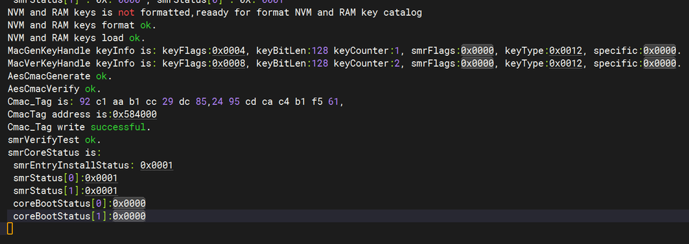

Next, I debug your project on S32DS and when the program configured secure boot completed, I caused a functional reset by pressing reset button (SW3) then application was performed (green led was blinking and the smrstatus[0] and smrstatus[1] both equal to 1 - secure boot was performed successful).
This is the log of cl_factory_s32k312_hse_fw_install project:
And this is log of secure boot application (after I pressed reset button).
The above image indicated that the advanced secure boot was performed successful.
I'm going to send your project modified and my secure boot application via email.
Dan

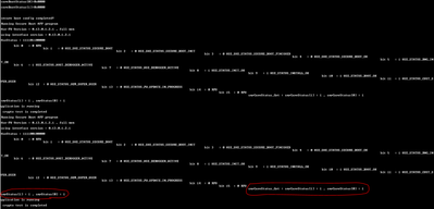

The problem is that when the configuration is completed and the app is successfully launched,
when you use PE online debugging again, it will cause the HSE_FW to work abnormally,
and it feels like the previously installed key is corrupted, and you have to reformat the key catlog and reinstall the key.
The video file I provided earlier,2024-01-29-16-12-29.mp4,The main operation process is:
cfg(with BOOT_SEQ = 1)->reset->app boot successfully->modyfy cfg project->debug again->HSE_FW fail
You can also replicate this phenomenon in your own projects.

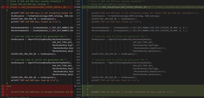

1.Uncomment
2.debug again with PE,it will stop here
6,419件の閲覧回数
nxf78987
To solve this issue, please add two statements into else as below:
Dan

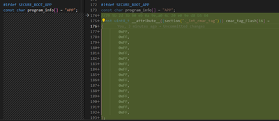

There is also a doubt about Advance Secure Boot, which involves the design of our software architecture.
Our products need to realize the upgrade function of APP. Our software is designed to configure the Advance Secure Boot while the product is in the factory.
After that, we provide an app upgrade package to replace the original app, and our upgrade package is with Cmac_tag.
cmac_tag_first,cmac_tag_new1,cmac_tag_new2,,, are different.
However, after updating the app_new and cmac_tag_new, I can't start the app normally.
I personally understand that when installing SmrEntry, the important information is the smr_src, smr_size, key_handle, authentication scheme, cmac_tag_pointer and legth.
I have always understood that cmac_tag_pointer is provided with location information, and the specific content of this location can be different, as long as it matches the calculation result of the corresponding region content.
If the HSE_FW also records the specific content of the cmac_tag_pointer, then the SMR entry must be reconfigured for each APP upgrade, which is too inflexible.
I hope my understanding is wrong, and I look forward to hearing from you,

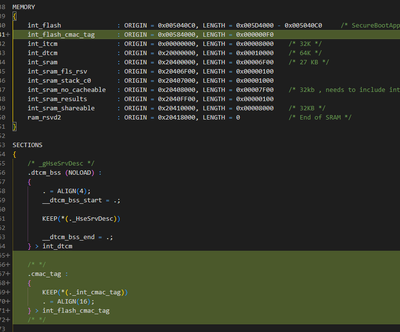

I realized that you configured int_flash area to overlap the int_flash_cmac_tag area in your application and maybe the cmac tag area can be modified.
You have to ensure that there are no areas that can overlap and can modify cmac_tag area.

luhaiou_autolink
Thank you for your reply to my queries,
int_flash_cmac_tag is not overlap,
We can confirm the file from cl_factory_s32k312_hse_app0_blinky.hex  in new branch

nxf78987
Pass:
Fail:
Dan
