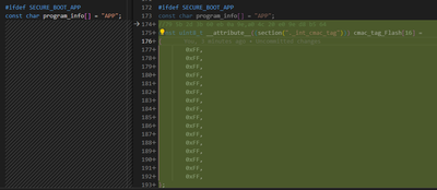

DanNguyenDuy
Hello @luhaiou_autolink,
I checked this situation and I detected that the CMAC tag value has not been updated yet at the address 0x584000.
Pass:
Fail:

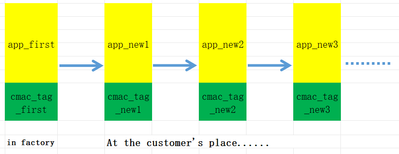

There is also a doubt about Advance Secure Boot, which involves the design of our software architecture.
Our products need to realize the upgrade function of APP. Our software is designed to configure the Advance Secure Boot while the product is in the factory.
After that, we provide an app upgrade package to replace the original app, and our upgrade package is with Cmac_tag.
cmac_tag_first,cmac_tag_new1,cmac_tag_new2,,, are different.
However, after updating the app_new and cmac_tag_new, I can't start the app normally.
I personally understand that when installing SmrEntry, the important information is the smr_src, smr_size, key_handle, authentication scheme, cmac_tag_pointer and legth.
I have always understood that cmac_tag_pointer is provided with location information, and the specific content of this location can be different, as long as it matches the calculation result of the corresponding region content.
If the HSE_FW also records the specific content of the cmac_tag_pointer, then the SMR entry must be reconfigured for each APP upgrade, which is too inflexible.
I hope my understanding is wrong, and I look forward to hearing from you,

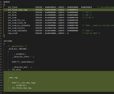

DanNguyenDuy
I realized that you configured int_flash area to overlap the int_flash_cmac_tag area in your application and maybe the cmac tag area can be modified.
You have to ensure that there are no areas that can overlap and can modify cmac_tag area.
Dan

luhaiou_autolink
Thank you for your reply to my queries,
int_flash_cmac_tag is not overlap,
We can confirm the file from cl_factory_s32k312_hse_app0_blinky.hex  in new branch
1.I would like to ask you to confirm that when using Advance secure boot, when the app is updated, the user will have to reinstall the SMR in order to store the new auth-proof to HSE Secure NVM.
May be auth-proof is stored directly in the HSE Secure NVM instead of storing the proof address in the codeflash.
This may be the functional feature of ASB mode?
21,890 Views
DanNguyenDuy
I asked the FAE team about your question and they said that:
the auth proof is mostly on the normal code flash.
but they have tried just update auth tag before when using the secure boot demo, it works fine, you can try the same process on the demo first.
Pass:
Fail:
