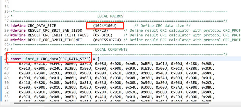

RTD Version is SW32K3_RTD_4_4_2_0_0_D2203, I just changed the size of the CRC_data array
I toggled the IO port before and after the CRC calculation to measure the time.

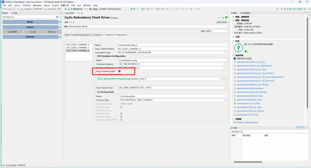

I'm using RTD 4.0.0 and the problem still exists
I used hardware to calculate CRC, When I checked the Dma channel Enable, the speed was not faster than when I didn't check it.

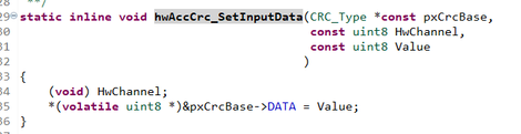

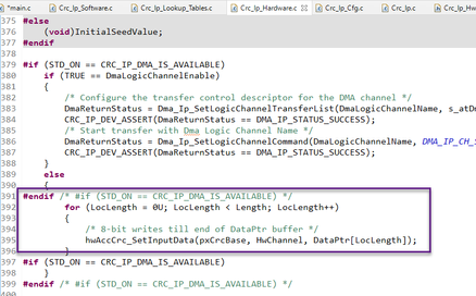

If the DMA is disabled, the core writes all the bytes to the DATA register within this for loop:
If it is done by the DMA (8bit transfers to the DATA register), it does not mean it is any faster.
But it allows the core to do other operations, while the DMA is transfering the data.
