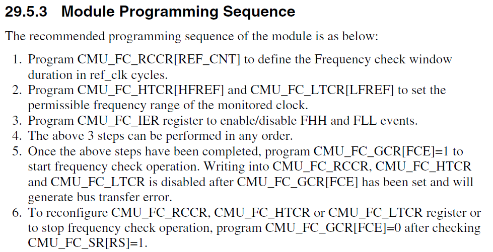

I am working with S32K118 and I am trying to configure the clock monitoring unit according to the below steps in the manual:
However, when trying to write in any register of the clock monitoring unit such as RCCR / HTCR / LTCR / IER / GCR ,
A hard fault exception is generated and I am unable to change the registers' value at all.
Is there some protection on these registers that I have to unlock before writing?

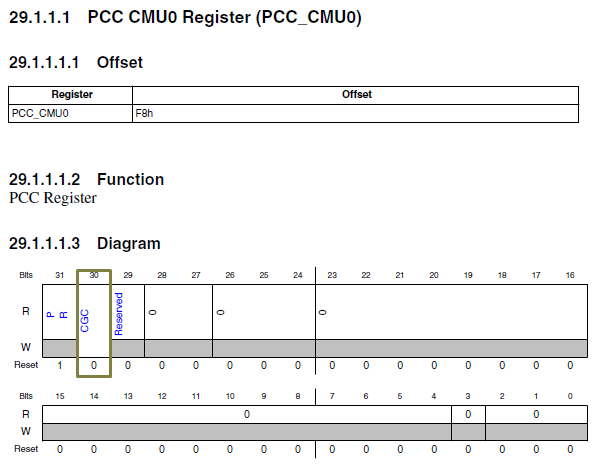

Hello Daniel,
Thank you so much for your answer. This was indeed the issue.

danielmartynek
Have you enabled the CMU clock?
