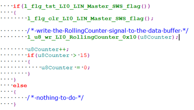

liuxing_hu
Hello Diep_TrinhXuan
thanks for your information, I have a problem when using master flag, I want to make RollingCounter add 1 when receive master flag, so code is below
keep mater node send msg, I power off the slave node, then I power on the slave node, the RollingCounter sent by slave have the following problem in the first/second frame
the correct RollingCounter shall be 0, 1, 2, 3,4, not 0, 0, 1, 2, 3
I guess it is a sequential problem, slave node have respond the msg after receiving master msg before application detect the flag is 1, so it's late to write the RollingCounter signal to the data buffer.
so do you have any suggestions?

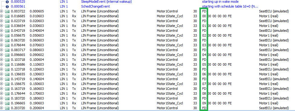

Diep_TrinhXuan
Hi liuxing_hu,
A key property of the LIN protocol is the use of schedule tables. That is mean all frames in the table will be transmitted sequentially.
So in my view it is possible that LIN_Slave_SWSL_send was sent before. And then RollingCounter signal is sent with value init(value = 0).
If your  problem is not resolved, please share me a image that contain all the frames that transmitted and received on bus.
Diep
11,840 Views
liuxing_hu
Hello Diep
here is the a image that contain all the frames that transmitted and received on bus,
the responseError in the first msg id 0x10 is 1
the responseError in the second msg id 0x10 is 0
