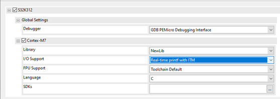

Dear NXP community,
As a first step I want to configure ITM and SWO such that I can push "Software Packets" on the serial wire using NRZ encoding. Once configured I should be able to write to stimulus registers of ITM and this should result in data coming out of SWO. From my understanding I need to configure the following:
1. Configure and enable GPO[10](This is done in reference to *.xls attached to the S32K3xx RM):
2. I also configure and enable TRACE_CLK, I am not sure this is necessary, can you explain/clarify. To make sure the TRACE_CLK works, I multiplexed it out to a pin and checked with a scope:
3. Next, global enable for ITM and DWT and also non-invasive debug enable:
4.Unlock and configure the funnel 0 and funnel 2:
5. Init SWO
6. Init ITM
7. Write to stimulus port using the following fnc.:
This however yields no results.

4,119 Views
danielmartynek
Hello @viktor_marhansky,
I'm sorry for the delayed response.
The topic is under an internal discussion right now.
In S32DS 3.5, a new project with prinft ITM can be created, but the retarget_itm library does not work as expected.
Once I have some new information, I will update the thread.
