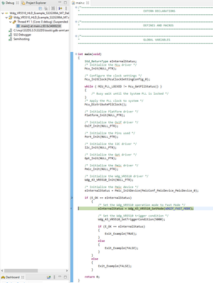

Thanks for your feedback. We have used the same versions that you are saying and under an RDB3 platform we see the following outcome with the "Wdg_VR5510_HLD_Example_S32G399A_M7" example:
In which the function "Pmic_InitDevice" is returning an E_OK.
Have you applied any additional modifications to the example? This should be the expected outcome out-of-the-box.
