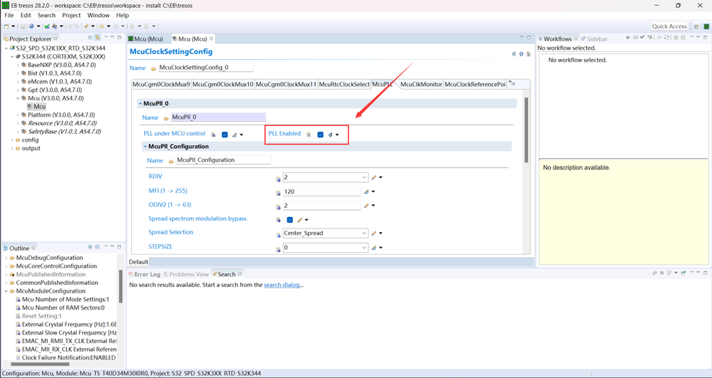

In the "safety->STCU2" section of S32K3XXRM, there is a register related to PLL monitoring located at STCU2->RUNSW. According to the description, when our clock configuration uses PLL, we need to enable these two fields.
In the demo provided by S32K3 Safety Peripheral Drivers version 1.0.3 Design : Product Download : Files (flexnetoperations.com), PLL is enabled.
Based on the above information, these two bits should be set to 1 in the STCU2->RUNSW register in the demo.

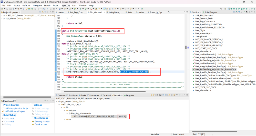

And in the main.c file of the provided demo, the place where this register is set is in BIST_RUN()->Bist_Specific_Run()->Bist_SelfTestTrigger()->SAFETYBASE_REG_WRITE32(BIST_STCU_RUNSW_REG, BIST_STCU_RUNSW_RUN_BIT);
However, in the case where PLL is enabled in the clock configuration, the library driver provided by SPD does not set these two bits to 1.
1. Is this a design flaw or do users need to manually modify certain code?
2. If it's a design flaw, how should we fix it?

I was talking to SW team as well as the HW validation team.
It look its weird combination of some PowerPC and ARM remnant in documentation.
They confirmed me that the bits are not set by the driver and it is not needed.
As the result the bits are on other ARM devices which carry STCU2 module marked as reserved.
I expect that during reset state these bits are set from factory DCF records so therefore you don't need to set them.
Anyway, Program STCU2 as per NXP recommended in SAF.
And since it has pass the tests, it is valid and PLL is used as test clock.
Peter

petervlna
This depends on if you are going to execute the BIST with PLL as the clock. If not, then those bits can be left with 0.
Setting PLL in MCU mode control set the clock to system. It does not mean the BIST will run from PLL.
That is set in BIST precondition.
So first clear out if you want to run BIST with PLL as its clock, then set the proper BIST precondition for it  (this should be documented in SAF /SPD docs) and run the test.

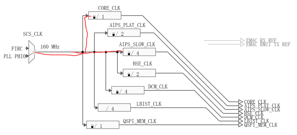

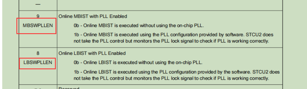

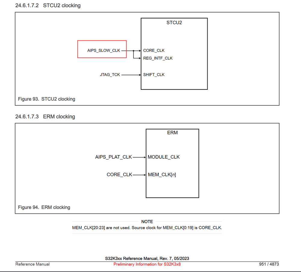

Pusoy
Hello,thanks for your reply.
However, according to the two images below, for S32K344, if the clock signal generated by PLL is used as the source of the system clock, then STCU2 will also run from the PLL.
