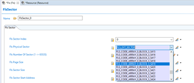

HI NXP expert team:
I have an S32K314 board with AUTOSAR 4.2.2, we've configured the DFLASH as simulated e2prom,and it works fine!
Next, I plan to develop soft a/b upgrade function, you see, by which I can upgrade B partition(BLOCK3-4) when AUTUSAR runs in A parition(BLOCK1-2) online.
But I just don't know how to configure the pflash erasable/writable since it seems that AUTOSAR has already configured the low level fls interface with dflash.
So, my question is: what can I do to approach the purpose?
Deeply appreciate your sincere help!

No, S32K314 is single-core with AUTOSAR 4.2.2. and we can only config dflash operation on it with Davinci tool, so if I want to operate(erase/write) dflash, OK, AUTOSAR has already support it natively,but based on this if I want to operate pflash on AUTOSAR furtherly , no way, right?

Hi @cfyywcc ,
What package are you using? As far as I know, dflash and pflash will be support to configure in driver. This is for pflash.

Logically dflash will be configed as nvm usage, but if I also config pflash as bootable B partition of full a/b solution, maybe I update B partition at the same time AUTOSAR will refresh some nvm item too, conflict occurs,right?
So, how can I do now?

Hi @cfyywcc ,
As far as I know, conflict just occur when you touch to same regions. pflash and dfash are on difference regions. In configuration, there is overlap error when you try to configure same regions.
