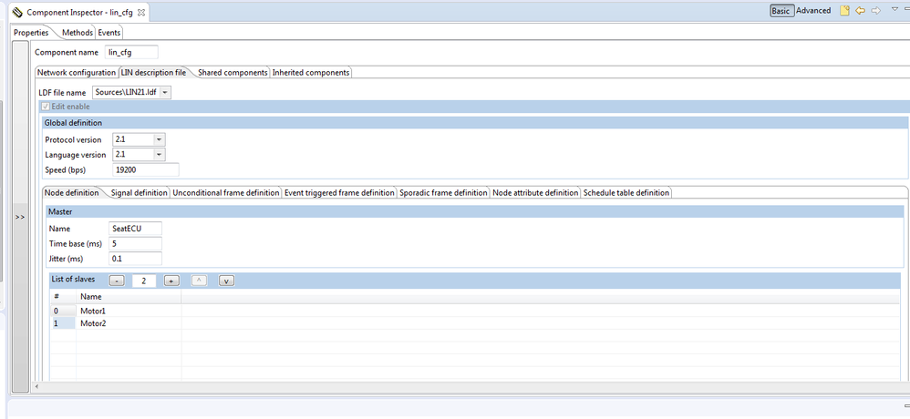

I'm not much familiar with the LIN interface - but you can start with S32DS LIN example. Click on File -> New -> Project from Example and choose S32K14x_EAR_SDK_v0.8.5 Example Project lin_master_s32k144
I assume that the node config file (npf) is part of processor expert:

the NPF file is not used for S32DS and SDK. Info from NPF is inside Processor Expert lin_cfg.
