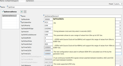

In SPI configurator, when I try to change the timing values for Clk2Cs, Cs2Clk & Cs2Cs from 0.000001 sec to 0.00001 sec, I'm facing an error.
But when I hover over the timing fields, it shows the timing can be set in the range of 100ns to 0.0001 sec.

Hi @VaneB, Seems like it is causing problem with code. I've set the timing as 0.00003 sec and checked, there is no response from the slave.

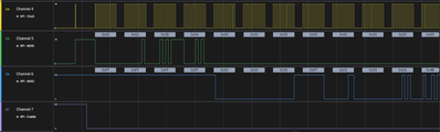

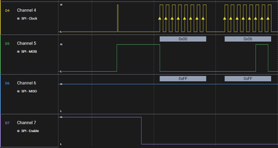

Could you share an image of the signals coming out from the S32K3?
4,860 Views
Riyasma07
Hi @VaneB,
The screenshot of signals from S32K3
Riyasma07_0-1712115553257.pngRiyasma07_0-1712115553257.pngRiyasma07_1-1712115802580.pngRiyasma07_1-1712115802580.png
4,842 Views
VaneB
Hi @Riyasma07
The signs seem correct, but to make sure the problem is not caused by S32K3, please try testing the SPI example with the settings you require.

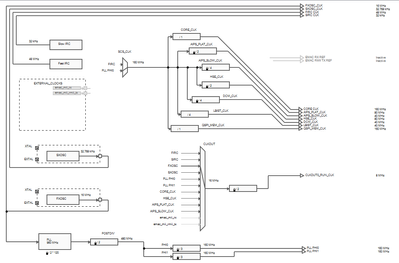

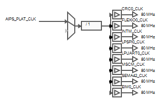

The clock configuration is
and I'm using SPI0

I had verified this situation and the cause of the problem looks to be related to S32DS and not for a wrong configuration. The error should not cause any problem with your code.
