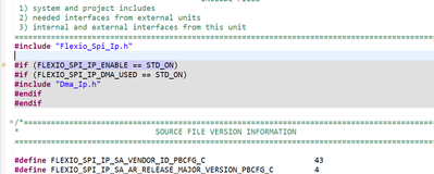

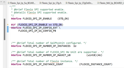

I'm using S32K312 board as master and TCAN1167 as slave and trying to transmit and receive.
(FLEXIO_SPI_IP_ENABLE == STD_ON) is enabled in Flexio_Spi_Ip_Cfg.h but it is disabled in the generated file. i hereby attached the snippet for your reference. Can you help us resolve the issue.
