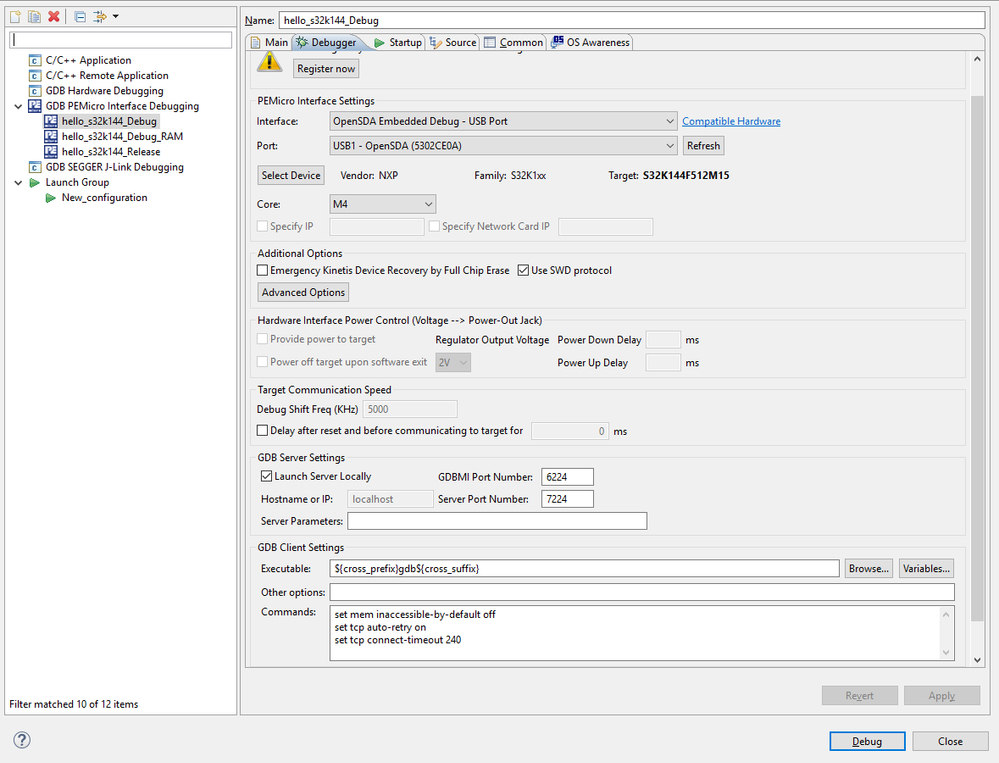

Now, I'm working on S32 Design Studio for the S32K144 EVB and when I tried to flash my SW to the board, I got this issue.
And this is my debug configuration:
Could you pls help me resolve this issue?

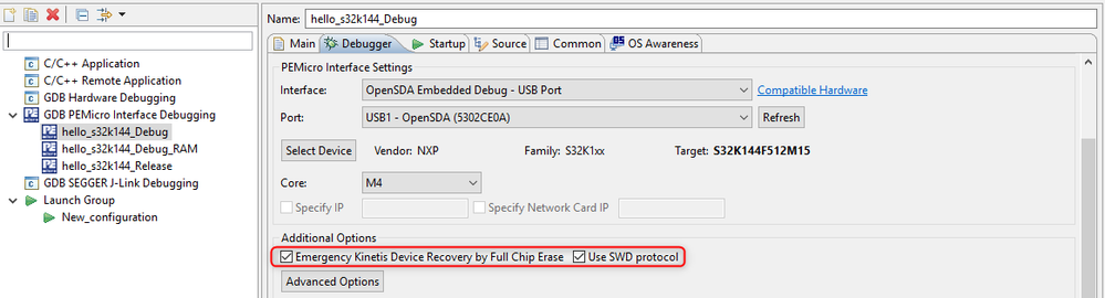

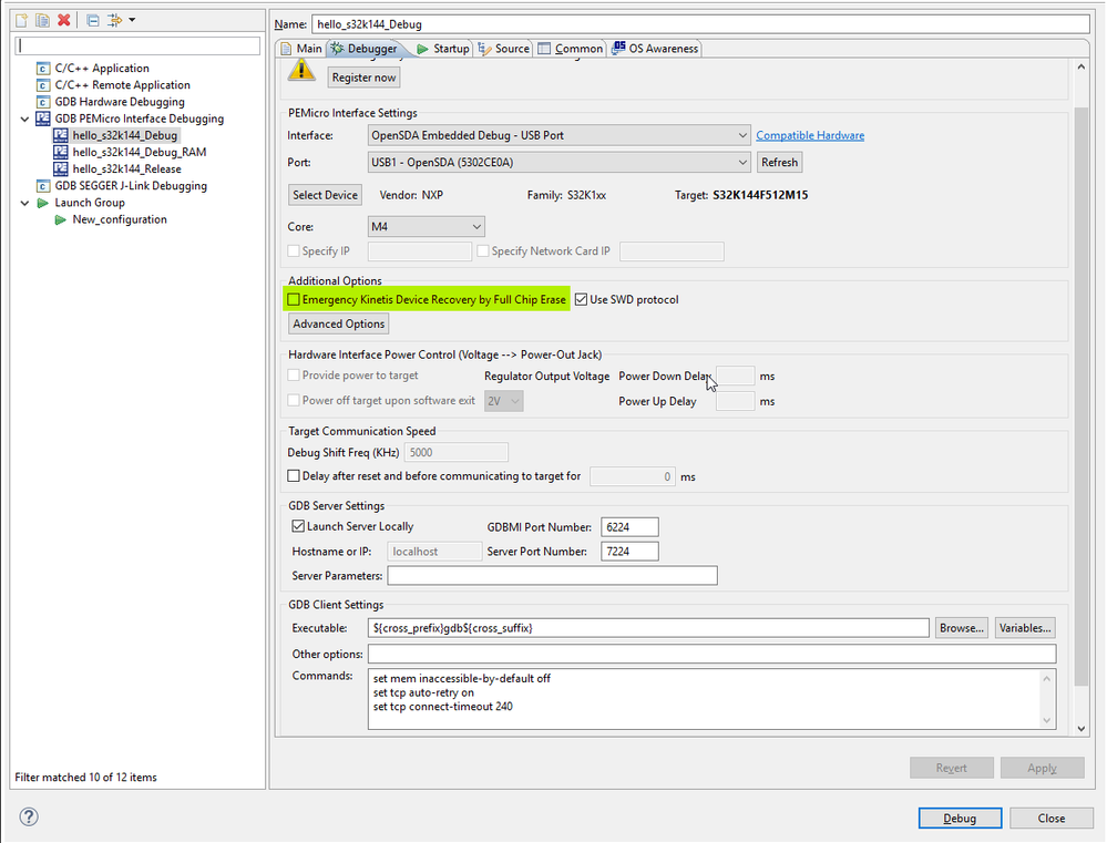

what about power? Is your EVB powered?  You can also try Emergency Kinetis device Recovery option:

Hi Jiri,
My EVB was powered and I also chose your option, but it still did not work.
