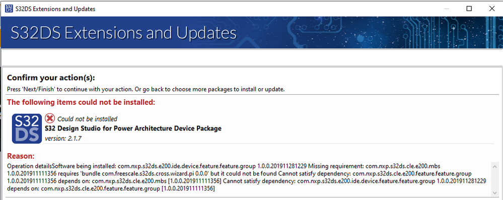

by installing all of the components of RSDK for RRU2 I encountered this problem:issue.png
Despite the fact that they installed all updates, the issue persistUpdates.jpg
Any idea how to solve this problem?
thanks

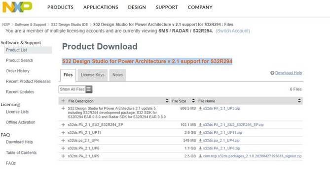

Most likely this is due to a dependency upon an updated support package from PE Micro. Try to resolve from within S32 Design Studio for PA by:
After the update is installed, then try to install the S32 Design Studio device packages again.
